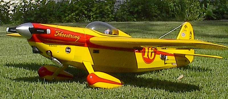

I have a G90 sideways in minewith a 13/8 apc prop. Very fast combination. Note I kept the cowl cutting down to a minumum. Friend of mine has the same plane with an inverted Saito 100. That would be my recommendation for you. I usually make low approaches which helps slow it down.

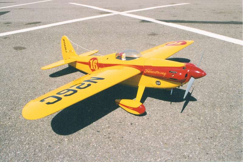

Byzandula, I did not want to cut up that neat cowl either, did some research and determined that all 90 2 stroke engines require cutting the cowl. Decided on the Tower .75 which does fit horizontally without cutting. Am using a Bisson pitts muffler which puts out a throaty sound , and supplies good pressure to the engine. I beefed up the Shoe with 1/4" spruce stringers on the fuse, epoxied the firewall and landing gear plate etc. Plane with all mods comes in at exactly 8 pounds. Have about 50 flights and am very pleased with this combo, the Tower has been rock solid, and no overheating problems in the fully enclosed cowl. I was primarily interested in the aesthetics of the plane, and did not intend to race it, but just for kicks, we radared it a couple of times and saw 98- 106 mph range, depending on wind conditions. This was my first Tower engine, bought it as a first choice, and have been very impressed with it so far, great value, go for it! Hope this helps.

You can cut the cowl without drawing attention to it. Enlarge my photo which is here on your thread and see what I did to allow the G90 to fit.

Byzandula, I have been using a 12x8 APC mostly for speed runs, and a 13x6 APC for sport flying. If you want to go vertical I would try a 13x5. The Tower gets it best power by revving up. Mine will go vertical till I cant see it.
