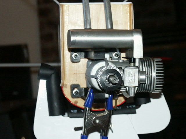

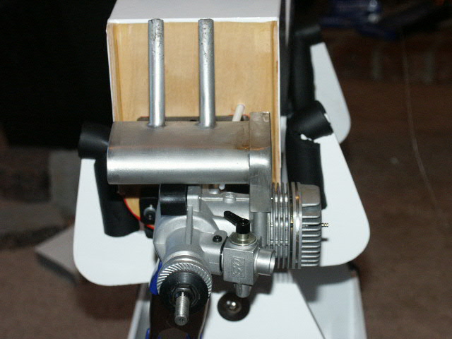

Here is some pics to show you what I've got. As you can see there is not much to work with. There isn't any straight line between the firewall and carb arm. Any suggestions now that you see the pics?
P.S. What's music wire? Where do I get it?

Get a wire that in diameter it does not bind in the guide tube and then make 2 bends to avoid contact with the muffler. The throttle arm takes very little force to move so the wire normally won't flex. Other wise you need to reposition your throttle guide tube. Music wire is stiff wire/rod normally stocked at a hobby shop.

Strulag, as I look at the photo on the left, I see a small area in the upper right corner between the muffler and the engine mount, which is probably what I would try for re-routing the throttle pushrod. That would run the pushrod along the side of the interior of the fuselage, and should clear the tank. You don't have to have an absolutely straight line from throttle arm to throttle servo; a bowed routing, if not too severe, will work OK.
I've had installations where I ended up plugging one firewall hole and drilling another, sometimes a third or fourth to get the routing right. I've seen installations where the pushrod was routed through the plastic engine mount itself--with a hole drilled through the plastic and continuing through the firewall.
No question, this can be a tricky part of putting a plane together. I have also used delman's trick of putting an offset bend in the pushrod wire so I can come out of the firewall in one line, and with two bends offset the routing to get around one obstacle or another. I had one ARF that was so poorly laid out I needed to put in a pivot arm to drive the pushrod through the only clear spaces available, offsetting the routing by an inch and a half or so. Sometimes you have to do some radical thinking to get these buggers to work right.

Hey majortom...That picture is deceiving because I took the picture a little from the left. If you look at the one on the right you'll see that there's no room between the mount and the muffler to the left either. Even if I go that way the rod will still have to be bent and will still touch the muffler. By the way...how do you plug your holes in the firewall? I might have to do that as well. It's hard for me because I'm very new to this. I don't even understand some of the terms in people's suggestions to me. One way that might be easier is to stick something to the muffler that doesn't carry the heat over to the rod.

OK, I'm looking at the photo on the left. I'm looking at the throttle arm. Behind the throttle arm the photo shows a small area of clear firewall. That is a simple line of sight, clear of everything, clear of muffler, clear of crankcase, clear of engine mount. This little area is "around the corner" of the engine mount from where you currently have the pushrod coming out. That's the spot I would choose, just from looking at the photo.
It may be that if I had the whole thing in front of me, I might find another spot I would like better, but the spot I'm speaking of looks like it should work. Complications which are unseen in the photo, such as what's behind that spot on the other side of the firewall, might need to be dealt with. Perhaps a shifting of the fuel tank. Perhaps another hole drilled through a fuselage former. This might call for a long drill bit from the hardware store, a 12" bit perhaps. If that's what you need, buy it, because you'll use it more than once. They don't cost much.
To plug the unused hole in the firewall, just cut off a short length of 1/8" dowel, or whatever size your hole is, tap it into the hole in the firewall and hit it with a drop of CA to seal it, or cover it with a dab of 5-minute epoxy. (By the way, if your firewall is fuel-proofed with epoxy, you should sand the surface before you try to epoxy over it. Most epoxies have a wax component that comes to the surface during cure. If you try to epoxy over cured epoxy, the wax will impair the bond. So just sand it lightly and the new epoxy will bond to the old.)
