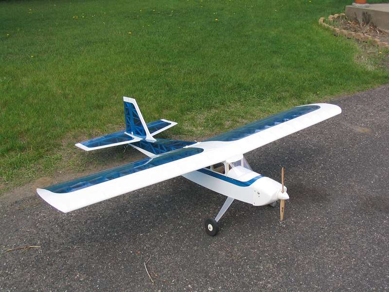

Hi Russ,
Thanks for the compliments ... I kind of eyeballed the gear dimensions, but it came out in the right ball park so I'm pretty happy with it. I wanted to avoid having them look too short or two tall ...
Yes, I installed the main gear just ahead of the forward cabin former (i.e. just ahead of the leading edge of the wing.) Ground handling is great. It's robust, it tracks well, and I can do near perfect 3 point landings (relative to my lack of piloting skill anyway.) :-) If you are careful you can touch this thing down with amazing gentleness. I've seen no tendency to nose over when taxiing or landing in grass.
I special ordered some aluminum gear from TNT Landing gear. They have an order form where you specify the various dimensions and a week later or so, your gear shows up ... it's about $25 a pop, so not extremely cheap, but it's all prebent exactly the way you want and has a nice professional look. If I had it to do all over again, I'd probably go a little thicker or a little wider on the main gear because it does have more flex in it than I was expecting. That hasn't been a problem though because on landing it touches down gentler than I ever would have imagined or expected.
I did go with the stock wheels ... I figured there might be a chance I would need to fly off a less than ideal surface so I stayed big with the main wheels. They seem like a pretty nice match for this size plane.
I'm running an ASP (same as Magnum) 61 four stroke swing a 12x6 prop for starters. That seems to be a pretty good combination. There's no point in trying to overspeed a Kadet ... things start to vibrate and that just slows you right back down. :-)
Some day if I get really bored, I might go buy some aluminum stock in an airfoil shape and make some fake wing braces. That and some wheel pants would be a slick addition.
I'm a moderately experienced sport pilot, so I wasn't expecting a lot out of the Kadet in terms of fun, but it's really great! It is big and slow and you can work the rudder and see the effects of slipping. You can do cross wind take offs and landing "by the book" and see the effects and have time to play with the cross controlled surfaces. It's *really* cool ... and does really nice rolls for a trainer ... better than my super sportstser 40 ever did. I'm thoroughly impressed with this airplane.
That said, it is slow and it basically can't go fast. If you over power it, you'll probalby start losing important pieces. So you just have to accept it for what it is and isn't and enjoy the classic stick and rudder piloting, and incredibly smooth and gentle landings.
Good luck with yours! I'm going to go fly mine this afternoon if the rain holds off ...

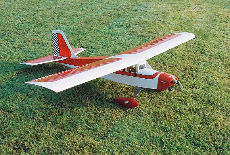

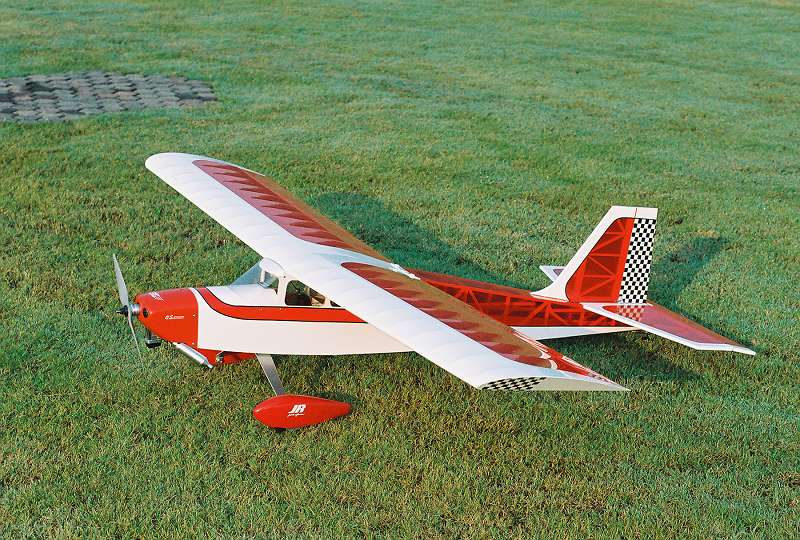

Here's mine with an ASP .75 stroke. Gears are GP 1/4 Giles. Wheel pants from Lanier 35% Giles kit.
It is one of my all-time favorite airplanes to bring out on a lazy Sunday.

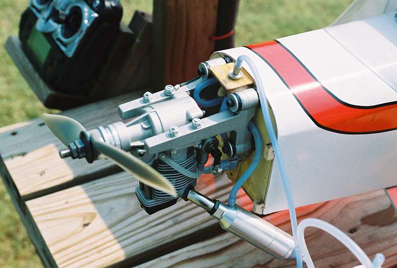

Great Job and nice engine instilation. Just started mine and I have several questions. I plane to use an OS 70 FS inverted as you have done.
Questions: Did you use the original gas tank and if so how lond can you fly EST...?
Any problem with the Muffler next to the plastic cowel (Looks Great)?
Saw an Eletric with Vent holes in the front of the cowel had planed to do that any Thoughts?
You said you had several dead sticks?? Just a new engine or possible problem??
Thanks For your time in Advance and would enjoy any further imput you have with continue flight testing of your plane.

Yes, I just went with the original tank. I think I could probably do 10-15 minutes at high throttle, and a *lot* longer if I putter around at just above idle throttle. I didn't have any problems with the cowl (it's plastic/fiberglass reinforced so it's sturdy.) I finally broke down and spent the money on a dremel tool and that makes doing cowl openings ***so*** much easier. I haven't actually flown with the cowl on yet, but hadn't planned to open up more holes than is necessary. I was running a brand new engine on this airplane and it's my first 4 stroke. I think I had it adjusted too lean and after I richened it up by quite a bit it started to run much more reliably. I'm not too worried about it, and it's certainly no fault of the Kadet. :-) I think it was mostly cockpit trouble. I'm planning to do further flight testing with an fma direct copilot and perhaps even a gps/flight computer so I'll try to keep my web site up to date if I learn anything interesting. As far as rudder and coordinated turns go, from the ground, I can't tell if aileron only turns are coordinated or not, so I'd say you don't really have to worry about rudder too much when flying the plane. But, the Kadet responds really nicely to the rudder, so if you want to practice slips and play around with adding rudder to make your turns better, this is an excellent plane for that. I've found that getting my slips under control with this plane has been a huge asset towards getting my landings on the runway. The Kadet is such a floater, it will putter past at eye level and not even want to land. But if you can do a bit of (controlled) slipping at key points in your approach, you can bleed off the altitude you need to put the plane down about where you want to.
Regards,
curt.

Fixing up the cockpit is another good idea ... I now have more good ideas than time. :-) One thing I think I'd like to do is go get some airfoil shaped aluminum stock from the LHS and rig up some fake wing struts ... I think that would be a neat addition ... along with wheel pants.
As far as the tail wheel goes, this picture hopefully tells the full story:
http://www.flightgear.org/~curt/Mode.../img_2478.html
The downside to putting a servo in the tail is that I ende up with 10oz of lead up front ... the Kadet hardly notices this, but it was still a big annoyance.
Here is one pilot option I was considering:
http://www.flightgear.org/~curt/Mode.../img_2438.html
I had a fairly knowledgeable person tell me that the ASP was exactly the same engine as the magnum ... same company, same building, just different names stamped on the side for different customers ... but I honestly don't know for sure ... I'm only repeating what I heard. I do have the Magnum manual and from the exploded view, it sure looks like the same engine too me, but if there are subtle differences, I'd probably miss them ...

hey guys - i was seen your tread on the senior - i did a tail-drager 3 years ago & also did my lt- 40 - the steering on the nois wheel was giving me fits so i converted over - it is so cool to fly - on the tale- wheel - i used a sig tale-wheel and did a pull-pull through the fus to the rudder servo and used the reg.rudder push-rod using a hole along the side - i had to relocate the rudder servo in the rear of the fus . i used sulliven pull-pull bronze cable (very small ) and silver soider pull spring on the end - my main gear went a head of the front cabin former. i used agood size main gear it sets up about 8" or so - 3 1/2" wheels - it reminds me of a cessna 185 - well gotta go good luck have fun bill wrcflyer

Posted on another thread but here are some photos of the completed Tail Dragger. Thanks for all the great ideas on this conversion!!
Joined: May 2005
Posts: 14
From: Birmingham,
AL
Thanks Curt- The wheel pants are Patty Wagstaff 1/4 scale and 4" Tires. Works great on our grass field. Also the cowling and wheel pants are painted with Automotive paint. Then sprayed with clear enamel.
Gil
