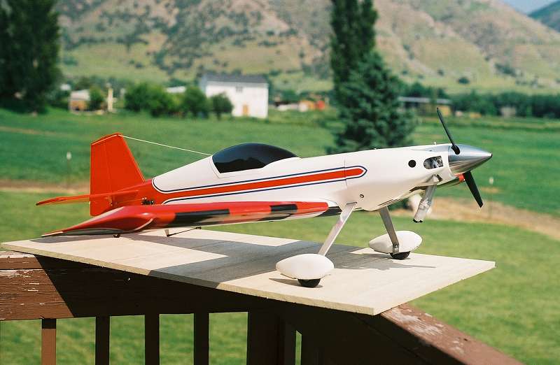

OH MY GOSH !!!! SOMEBODY FINALLY ENQUIRES ABOUT THIS ARF ? !!! Godflesh, I'm totally surprised by this. Here's the scoop. It's not available here in the US, you would have to order it from Galaxy Models in the UK. Not a spectacular performer but quite unique. Very costly to buy for a forty size ARF. As far as I know. I'm the only person with one here in the US. About $261 including shipping. It's well built for a Seagull ARF. I did a number of improvements to mine, like better scale landing gear, Ultimate spinner, smoked canopy, side-mounted Enya .50 w/Pitts style muffler etc. Quite a conversation piece at the flying site. Hangar 9 is not interested in selling it even though they carry Seagull ARF's. Quantum can't get them either. If I had the capability to put photos of it on this site I'd do it--- I'll try, asap. Out of my 28 aircraft, I treat this one like it was my new-born son.

GodFlesh. A Saito 72 is WAY TOO BIG ! It would really mess up the cowl trying to fit it. It has a very slim profile cowl. I chose an Enya .50 because it is the smallest .50 on the market and will just barely fit inside mounted at a ninety degree angle. You may have to sand/shave the corner/edges of the engine mount box to make the cowl fit properly. Quite a tight fit. Use a "Pitts" style muffler for the Enya. This engine hauls the plane around quite fast. It's a lite airframe too. The stock landing gear is too thin/short , so I made my own , more scale in length and appearence. Makes a big diffrence in scale looks. I installed a bigger fuel tank and "smoked" the inside of the canopy for a mystque look. Also, take the rudder servo and move it up into the wing saddle area. This plane is way too tail heavy. Use a pull-pull system on rudder and you will need a servo reverser for the elevators. I would suggest an "Ultimate" style spinner from Dave Brown Products [ 2 and 3/4 inch Diameter]. My total cost for this little .40 size ARF came out exactly at $800 US dollars. I treat it like a new-born baby, flying it sparingly, never doing anything wild with it and after a couple flights, I just show it off. I am a total "idiot" for spending this amount of money on this little plane but it 's the only way of getting a Harmon Rocket. There's nothing else on the market even in a kit form. And I hope nobody else would be stupid enough here in the states to do what I did. I wil post photo's of it within the next two weeks.....finally. Let me know how your's comes together. Seeya, MM PS, It weighs in at about six and a half pounds and is a real smooth flyer, no bad habits, floats in on landings.

mm that looks very scale indeed. excellent job - passes of for the real one anytime. I guess you can't really call it a semi-scale like whats written on the box. I'll be looking for a smaller 2-stk to avoid cutting the cowl like you suggested. Say, what's the height/length of the u/c that you fabricated? Would save me some effort by geting it right the first time. Thanks for all the info so far and great pics also.

Sharmanc, Well, ya,..... I am a little impressed with it myself too! I did not really measure the new landing gear as much as I just kinda sized it from a side photo perspective of a real Rocket. I have this talent for shaping things from just "eye-balling" it. The only two-stroker that seems to fit without making a mess of the cowl is that Enya .50 with a "Pitts" style muffler. You will certainly have a tail heavy plane with three servos back there unless you take the rudder one and move it up front and turn it into a pull-pull setup. The Enya is quite lite in weight. Dave Brown products makes the Ultimate spinner, I believe it's 2- 3/4 inch diameter. It all depends on how you want to dress this plane up. As I mentioned earlier, this is the only one of its kind here in the US. Exactly $800 us is what it took to complete this 40 size ARF, Fortunately, no one else here is foolish enough to dump that kind of money into this. It's an average flyer with no bad habits but it sure is a conversation ityem at the flying sites I travel to so I fly it very carefully and sparingly too. There are no plans to distribute this ARF here in the US so it's treated like my new-born son
