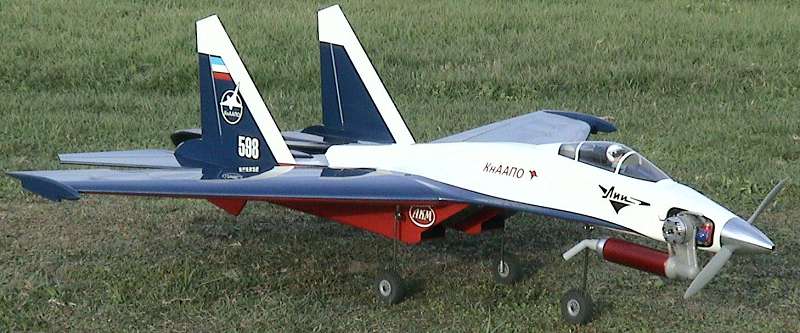

DONT FORGET THE FLANKER... NOT BAD LOOKING EITHER! NOW WE HAVE THE MAKINGS FOR ACM ENGAGEMENTS!

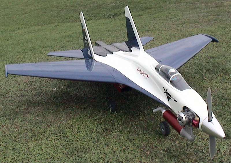

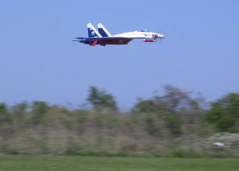

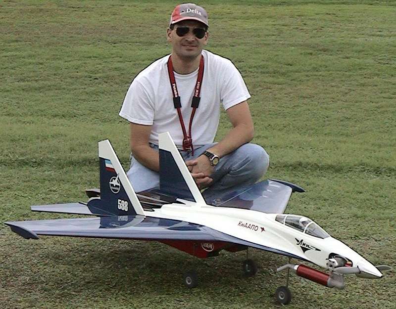

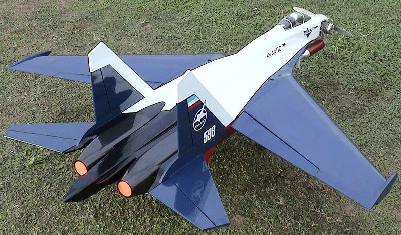

You can get the SU-27 Flanker at: http://akmodels.bizland.com/ E-mail or talk to Alex.
It is not an arf but a 90 sized laser cut kit... tell Alex at AKM I sent you to his site and he will give you a FREE set of the laser cut stickers if you order the kit! I love the plane... flys as good as it looks!!
It was a pleasure to build and fly! Here are some more pics!
That is a sweet F-16.... its gonna be my next plane!
