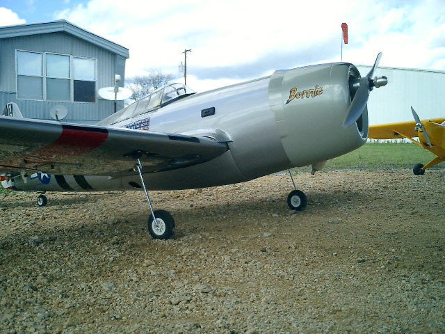

Whats going on with thier idea in the manual of using the 4th hole out on the aileron servo? Even using the outside hole in the control horn I am getting a hefty 1" throw in both direction! Any ideas appreciated. [X(]

I'm using the second hole. If need be, you can tone them down with EPA/Expo. That's what I did. A nice flying plane, like it a lot.

Hi cruz, thankx for the info. I have lots of planes and only 2 non-puter radios so don't want to get into EPA/Expo. I will hook up to the 2nd hole and see what it looks like.Glad I increased the servo tray gap!

No problem on the help. Remember hold a little throttle in on final, but she'll probably still float more than you think. I know mine did. Best of luck.
