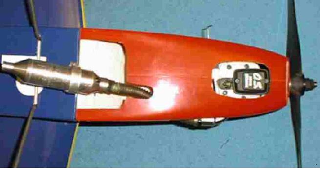

the only mod is in the picture .

engine OS 91 surpass III

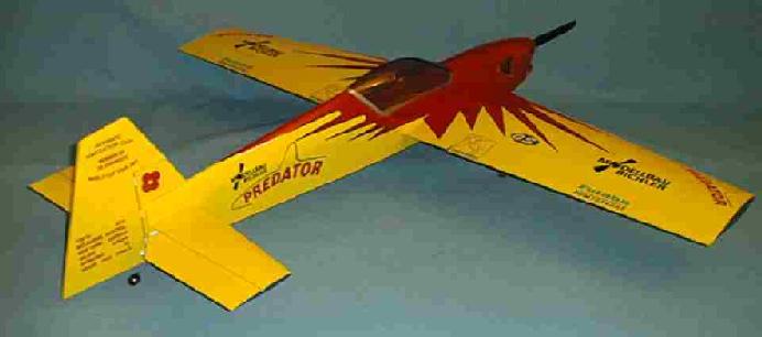

My Predator

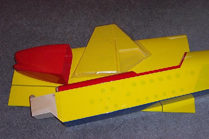

Out of the box.

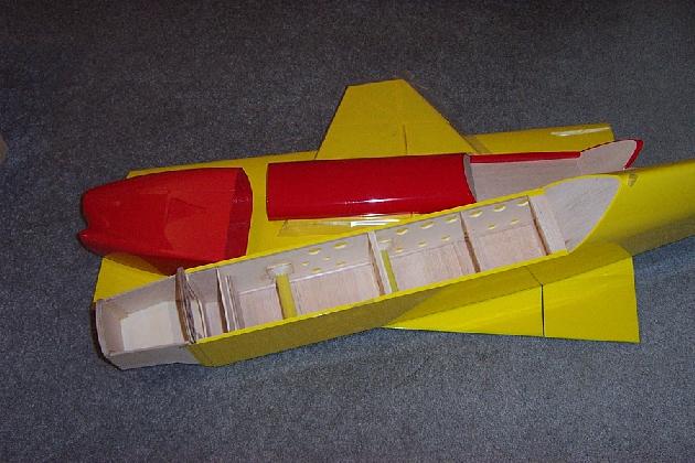

One more.

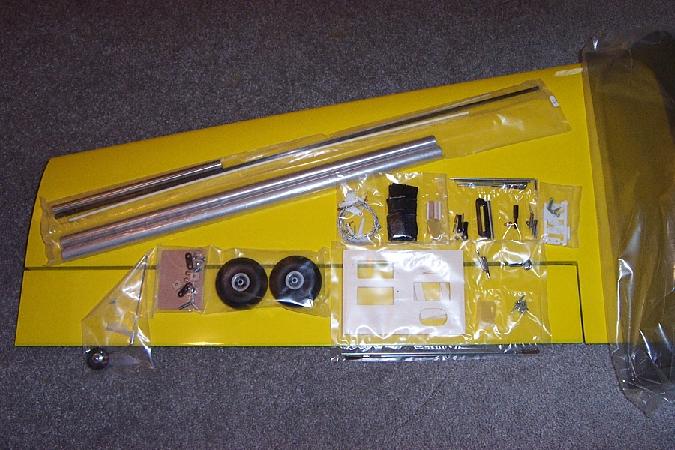

Hardware

To mount the OS91 SURPASS III I used the original OS
alloy mount re- drilled to fit the clearance .
It is mounted off center to get 2.5 DX degrees .
Te do it I arrived to the extrem Sx . of the firewall !!
Nico

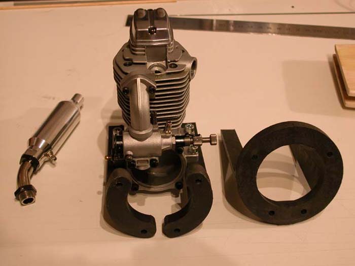

Try a Dave Brown engine mount... or a Protech square based engine mount. I use the Dave Brown one on a 8 cm width firewall.
Cheers,
JYM
