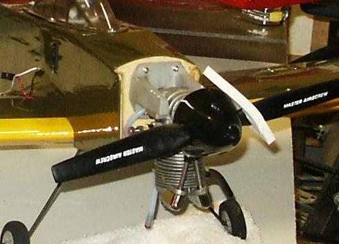

Mine has had 3 different engines so far. When I first built it I used an old Saito .45. This worked fine, but I didn't like the weight, so I changed to an old OS .25 FSR. This reduced the weight quite a bit, and flew very well. Then I picked up a new in box OS .32 FSR on eBay. This is the engine it's got now and I think it's great. A couple people estimate it flies about 90 MPH. Someone else in the club has a Great Planes F-15 with a Rossi up front. We do formation flying together. The .25 FX that WCB mentioned would be a good choice.
I was going to say I had no pictures, but I happened to find one when it had the Saito on it. If I recall correctly, I never actually installed the cowl when it had the Saito. Note, the mount in this pic is not the standard one for the plane, it's made for the Saito. When I removed the Saito and switched to the OS I went back to the mounts shipped with the plane. Here's a cut showing the engine.
Quiz of the day: Can anyone figure out why I've got a piece of foam on the prop?

My guess would be to keep the prop from rotating, opening the valves and allowing oil to collect in the head.
If not, my second guess would be blue.
