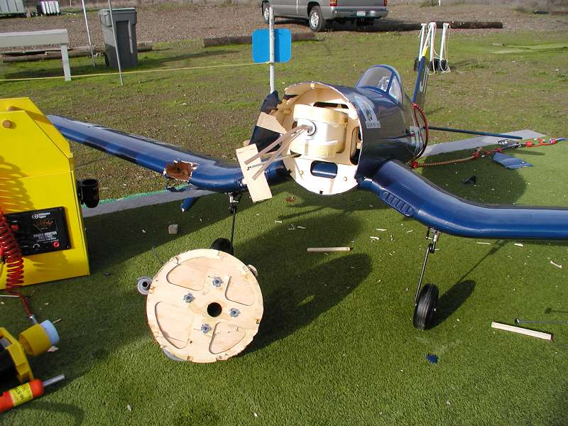

Ohh man that really sucks?
looks like you took an axe and chopped it or the firewall thought it was a missle and wanted to fly off. (hey if you are selling the plane let me know, I could use the retracts

I've seen small electric foamies whose firewalls were attached better than that! What is it, a H9 .60"
This aircraft is not, I'd witnessed a similar in-flight failure, one example is not enough draw a conclusion. I went to the net and was surprised how many were complaining of failed firewalls, then I saw this picture. If you look closely, you can tell the only thing holding the firewall on was the sheeting. I wouldn't trust it to hold a .15 would you? [X(]
I have witnesse similar issue with many reputeably 'quality' ARFs I see at the field, biplane wings ripping out (factory installed cabanes screwed into nothing but sheeting), flying boat engine pods departing the plane (not glued at factory), wing centres failing (cheap luan braces), covering departing the plane in flight etc. etc.
