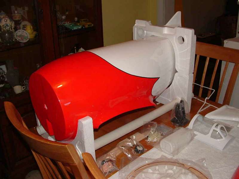

About 2 hours ago UPS arrived with the Gee Bee, I stopped eating dinner to open the box and see the contents. I am very pleased how well everything looks.
The painted Fus is very smooth, Only thing I noticed was a couple of small winkles on the wings but nothing heat will not take away. I do not like the Foam Tires, Or the Tail wheel but I will figure them out later when I've had more sleep.
I am very impressed with the size of this model, WOW!
I have been thinking of a YS 110 or Saito 150GK, Not sure just yet so keep your comments coming please.
Here is a couple of small photos of what I got to unpack so far!!!

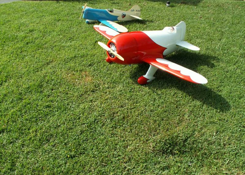

We an Update on the Gee Bee, The Belly Pan is a perfect Match to the bottom of the Fus.
I have read alot of Post's about this being a fitting problem but I test fitted my Pan and it matches perfectly, I must have got lucky on that one. I am still deciding on the engine, Either the Saito 150GK or YS 110, It is really a hard decision to make. Also I have been looking does anyone know if you should use a spinner or a hub type spinner?
Well if anyone has any photos they would like to share of their Gee Bee I would love to see them.
[8D]
