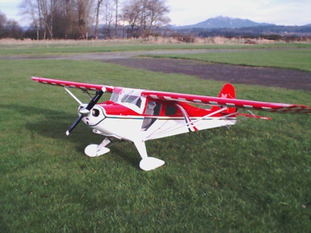

I have had one of these for about a month now and flew it for the first time 12/30.I used an OS 160 4-stroke twin that I had picked up some time ago that needed a home, and this was the perfect plane for it.It fits in the cowl without any cut-outs other than cooling air exit at the bottom and a small hole for the needle valve adjustment.With this engine it flies in a very scale-like manner and will do any aerobatics the full size plane will do with power to spare,plus the sound of that twin is very cool,especially on a low and slow pass over the runway.The quality of this ARF is one of the best I have seen and I made very few changes other than the tail-wheel and a couple pieces of hardware.I also used two elevator servos and modified the landing gear support rods using coil springs and heat-shrink tubing for bungees.All of the changes I made were pretty much personal preferences and I'm sure the plane would perform just fine with the stock hardware.

Hey Tailspin, What servo's did you put in yours? Did you need to use hi-torque, and what did yours weigh?? Thanks for the info, getting ready to get one, Yours is really nice!!!!!!!

I used Hitec 625MG servos for all of the control surfaces and a standard 422 for the throttle.I also used an 1100 mil. Ni-Cd pack mounted under the rudder servo to balance the plane.I think with the extra weight of the engine I used that the plane is probably on the high end of the range for this plane at around 15lb. or so, but seems to fly just fine at that weight and slows down OK for very smooth 3-point landings.I think Hitec 605 servos would probably be the minimum for this model.A lighter weight 2-stroke or 4-stroke single used would also result in a lighter aircraft.Hanger 9 used both a Saito 180 and a Zenoah G-23 in their prototype planes.With a G-23 it would weigh even more than my plane so weight is probably an issue only depending on what kind of flying you want to do and how difficult the plane is to balance with the heavier gas engines.One of the new lighter gas engines such as the RCS 140 would also be an interesting choice.

You have the engine I wanted, it is the perfect choice for this model. I am going to start mine this weekend, powered by a Saito 1.50. It was my 2nd choice for power only because of the price, down side is the it looks like i will have to cut a hole in that beautiful cowl. It kills me to think that I have to do that. I may be able to mount it inverted without any cutting, but I have not had much luck with inverted glow. Nice looking model you have and if you don't mind I would like to use your mod ideas. I may also go with a completely finished cockpit.
