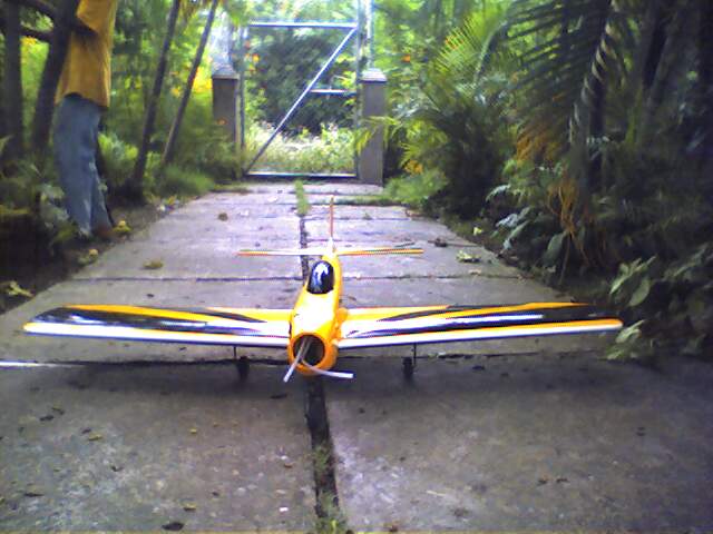

Old 08-01-2005 | 10:59 PM
Joined: May 2004
Posts: 13
From: miami, FL
Default RE: New KAOS, What engine?
I just bought the AX and 50 sx. Well my friend actually bought the 50 but he said I could stay with it if I wanted to and he stayed with the 46(good friend want me to fly planes). I ll properly break in both of them and test them. I like speed but love precision.
Just placed the plane on a digital scale and it weights in at 4.24 lb. Don t know how how much does the original weight ?
Also bought the hitec 7 receiver I ll be using 9 chp futaba.
As you can see the plane has a kougar wing.
Forgot to order an extra crystal.
