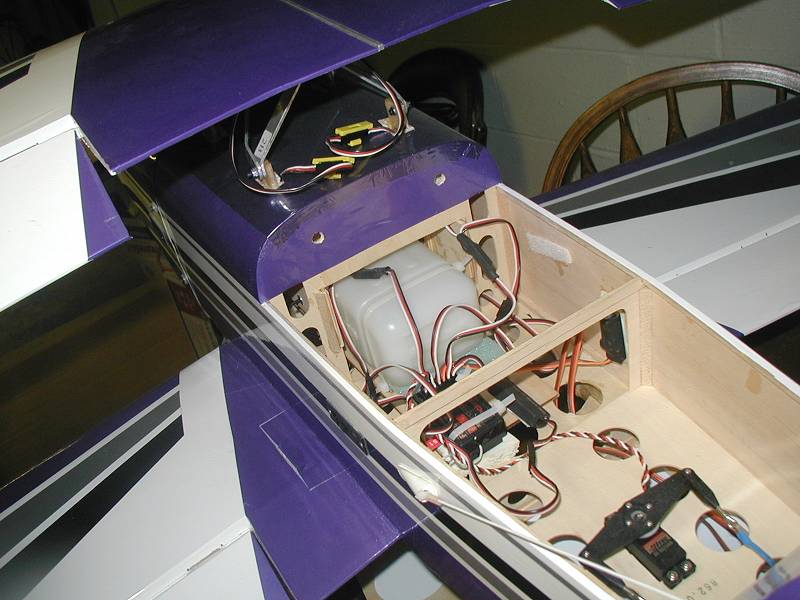

I have one of these planes and just love it. It had a few assembly & fit issues, but nothing too discouraging. I'll highlight
#1. Wing alignment dowels. I pulled them out of the wing, replaced them with 1/4 20 nylon bolt & hardwood block. Do yourself a big favor - pull off the bottom covering of the fuse, make a removeable plate, (under the wing) that way you can cinch the nylon bolts tight, and you have an additional compartment for gear. It is also a lot easier to install the pull pull with the bottom of the plane uncovered. and you can check the framework out in case it needs attention (i found a cracked former i woulnt have otherwise caught.
This modification took less than one evening, the surgery on the wing resulted in a small patch in the covering - no big deal.
I'll post some pictures if anybody wants to see how i did mine.

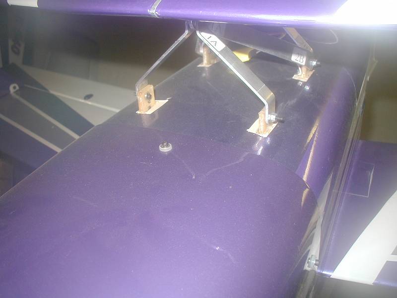

#2 The cabane mounts in the fuse started to 'woble' (i noticed this during transport when i would carry the plane by the center aluminum rib) I corrected it by cutting the square out that the 4 cabane mounts made - this entales cutting through the sheeting and foam. this exposed the 4 mounts so i could slide a reinforcing plate to reduce the flex. Replace foam and sheeting, recover. This was kind of a pain, but if you do it during initial assembly, it wont be so bad. I also glassed the inside of the box & firewall - that 3.2 has some umph!
#3 this one is easy- replace all those screws w/ hex bolts and blind nuts installed in cabanes. Also save the metal hinges for your screen door I used some Klett giant scale hinges

Hope this helps. I just swaped the dowels for the nylon and small block(in wing), nuts go inside hatch. I also wraped the cabane mounts w/ glass to beef them up.

Ted, thanks for the pics. Now I understand.

I have been getting everything ready for this coming season, when i knoticed a little wobble in the stabs (almost like they were not pushed all the way on the tube when they were drilled.) I was thinking about making a shim to tighten it up (a thin 'rib'' between the stab and fuse). I dont know about flying wires (where is the hard points?) Anybody else notice this? Any ideas?

I know this sounds kinda lame, but you could turn the stab tube 90 degrees & re-drill it.
The other option is to inset two tabs on each stab & attatch to the side of the fuselage. You would have to build hard points into the fuselage. A lot of work, but very solid.

I thought of that too, but when i drilled the stab initially, I KNOW i presses the suckers in tight! (The wood in the fuse is probably the culprit)
Good idea with the tabs.
