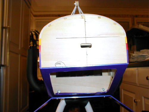

If you find something please send my way as well. I am just sitting here scared to cut into the firewall. By the way has anyone else found a problem with clearance of the the control horns on the rudder in reference to the rear of the fuse? And also the length of the screws to mount engine on the mount itself? Some hardware just doesnt seem right. May just be me considering I dont know what I am doing.
In the picture you will notice in bottom left corner the marking where the muffler has to go. Any help is appreciated!

The rudder horns definitely need to be trimmed because at full deflection they hit the fuselage. Either trim them or replace them. I found it necessary to replace some of the hardware because it just didn't fit or wasn't very good quality, such as the wheel collars.

Default SAITO 1.80 MOUNTED W/ MUFFLER
Finally got around to mounting my saito on my DP ulty today. Was not to hard just had to dremel out about 1/4" off the firewall away where it would not clear. only took about 30 mins or so to get it right.
Anyway here is a pic of what I did, for all of you who are at this stage I hope it will help a little.
