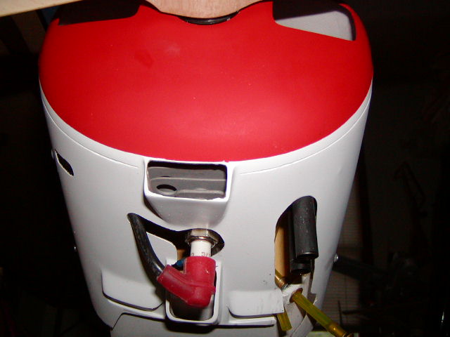

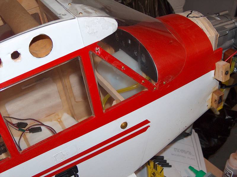

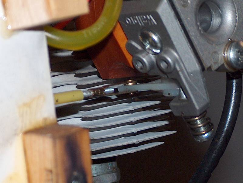

Sorry it took me so long Tiago I have been pretty busy. Here are the pictures.
1 and 4 are pictures of the throttle linkage
2 shows how much 1/4 ply I added to bring the engine forward enough to have clearance for the prop.
3 shows the ground location and switch
5 shows the gas setup and fuel dot
Hope these help
Lee
