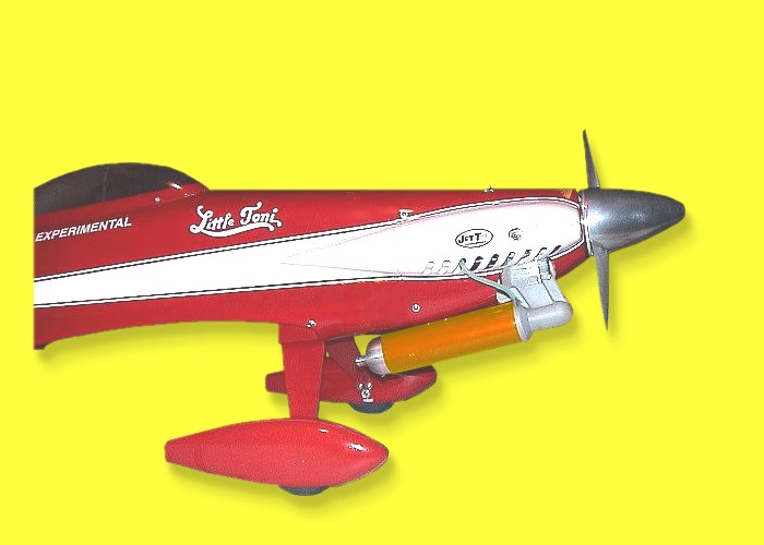

There are few really quick setups for the Shoestring.
1) you can use the Jett 90LX engine, as typically installed in the Toni and Minnow. The installation is pretty much the same. Serious power. Utilize 11x9 and 12x6, 12x7 props. Photos below. The 90LX turns 11x8 over 14,500 and generally gets the 11x9 up over 14,000 too - unloads great in the air. I can provide additional details if you desire.
2) A standard Jett 90L equipped with a Turbo-Jett muffler is another great choice. Photo of install in a Shoestring below. More torque, bit lower rpm (12K - 13K range), a bit quieter. Set this up with 12x8 and 12x9 props for speed, or a 13x6 for quick and balanced performance. A little bit of cowl work involved, but nothing that does not look good when done.
I hope these suggestions are helpful
Bob
edit added: yes, the shoestring is a bit larger. Needs a 12 or 13" prop. The turbo-jett muffler on a Jett 90 works well here. If you want more prop, the Jett 100L or 120L engines are the same "60" size as the 90L, and with a similar turbo-jett muffler are very happy turning 13x10 or 14x10 props at lower rpm (10-12K range).
