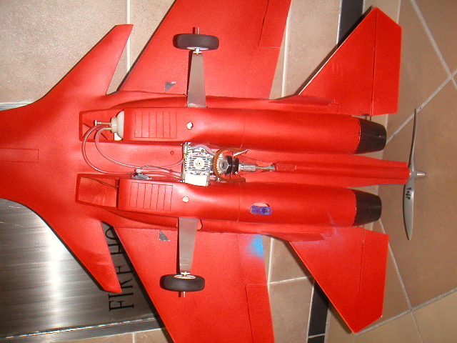

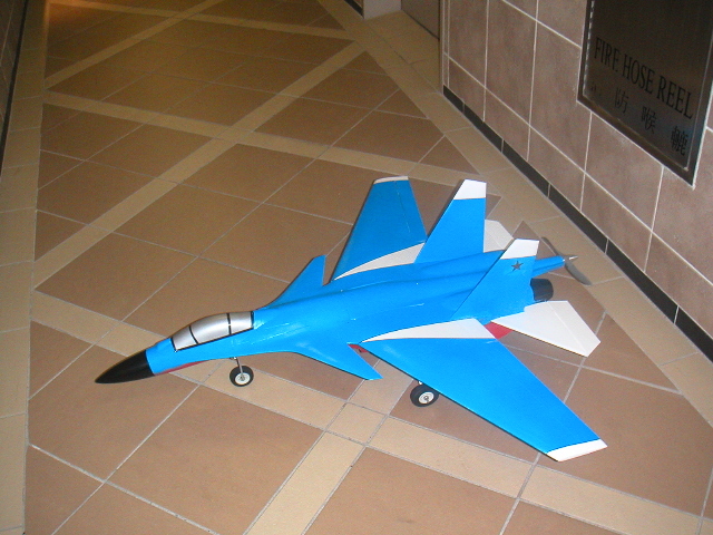

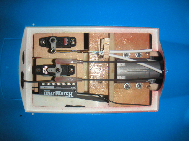

i've always wanted to relocate the engine midships so that the whole engine is hidden. then use a prop shaft to get the power to the front. i've done this on a pusher but am a little scared to due the same thing on a tractor since the prop may just fly out and smack someone in the head.
this is my prop jet. it's from an AMD slope glider. O.S. 32SX

forestroke: that is sooo trick! [sm=thumbup.gif]
Are you using a boat flex drive setup?

Kmot - yep! i figured if it can work in water, it should have no problems in the air. i only flew it one day before selling it. i was leaving hong kong and the guy loved it. so with tears in my eyes, i let it go... i'm glad it flew, though... otherwise it would've been absolutely worth nuts

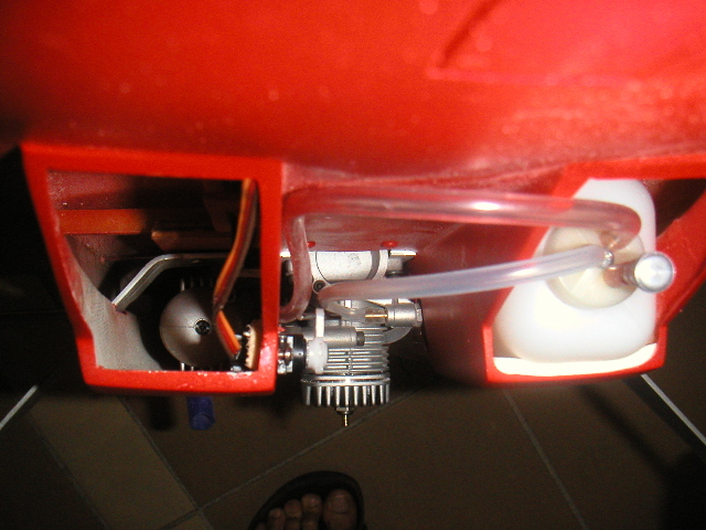

i love the fact that the engine is a stressed member holding the gear together. here's another picture.
but i really hope that someone makes another one. LOVE to see it.

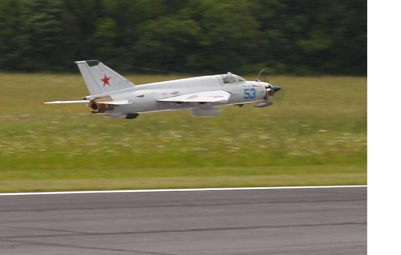

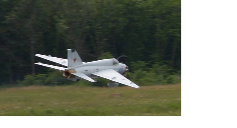

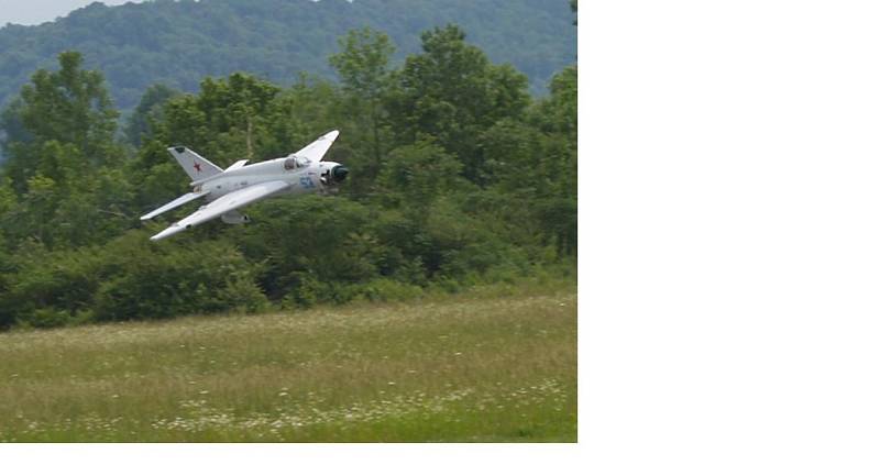

Only have one or two in flight shots of my first flight. Now that I see it flies I am going back and adding retracts to it. I thought the performance was marginal with an OS 61, so I am going to "upgrade" to an OS 90 two stroke...

Doc, looks damn good for a prop jet.

Thanks Muggen, in reality other than the sound, you would have a hard time not knowing it was prop plane. Flies nice, but you really need the power to get her in the air. Once there she flies fine. I have noticed the tail slides in the turn, probably related to the fact that the original design did not have a prop wash spilling against the vertical stab. The flaps really help with landing. Be sure to have your elevators set to high rate for landing, and use some expo. I am going to add a set of SpringAir retracts t omine, it just doesn't look right to have those wheels hanging down.
BTW mine also had a little damge to one of the blisters on the left wing. Although it is only cosmetic, it would be nice to be able to replace it.

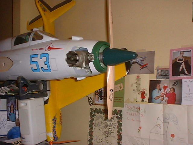

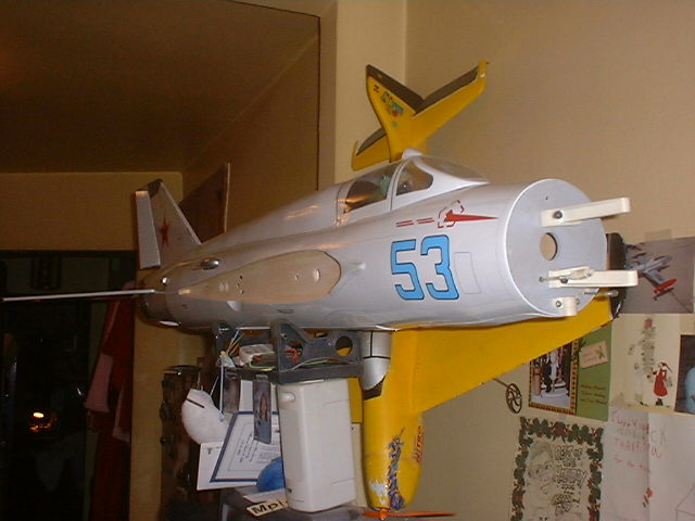

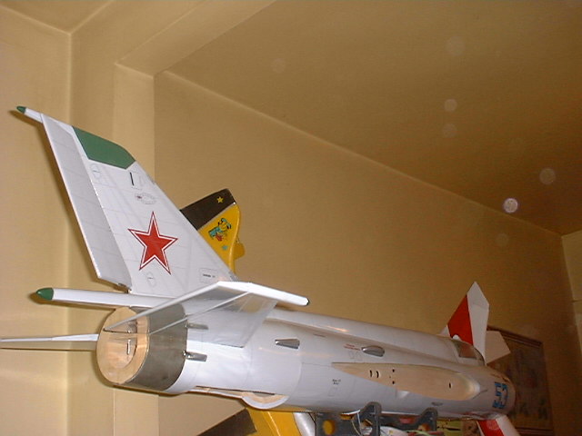

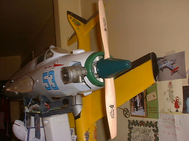

HI HI. Here whear i am up to. Setting it up with 108 for power GETME2 (JOEY)

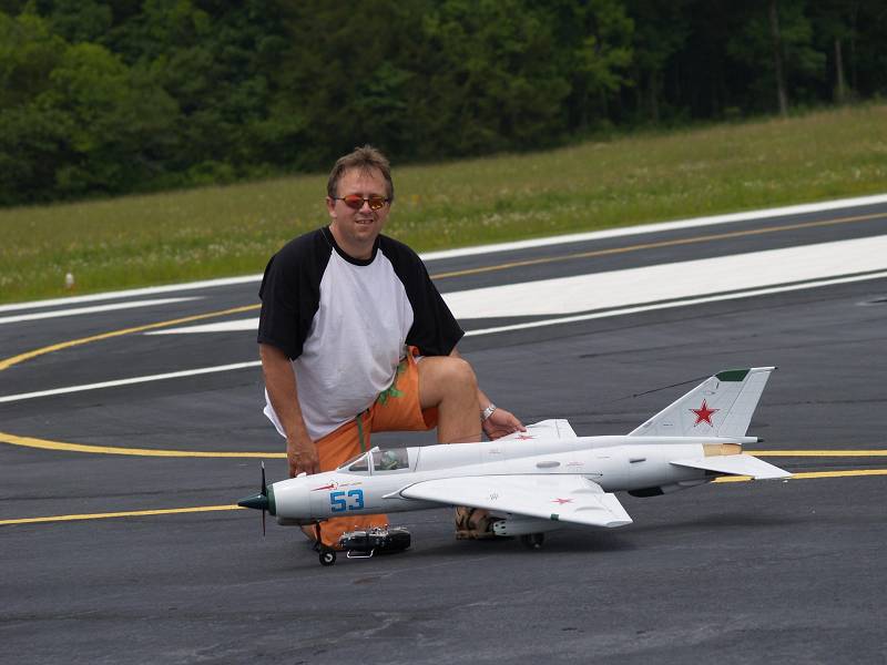

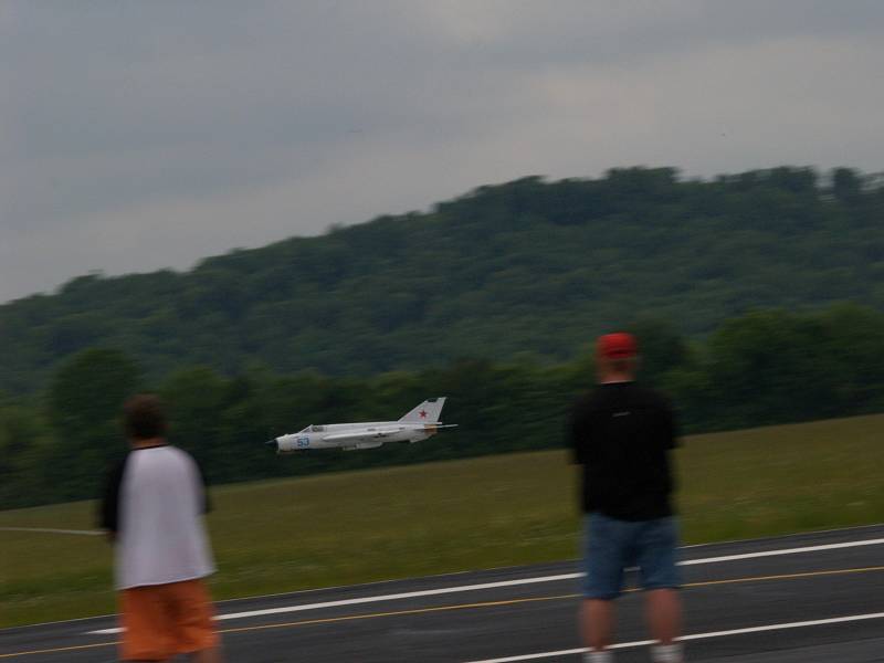

More flights on mine yesterday. The .61 is really humming. I have now installed retracts and you can tell marked inprovement in the performance. Turns on a dime and rolls like crazy. I love this plane....
