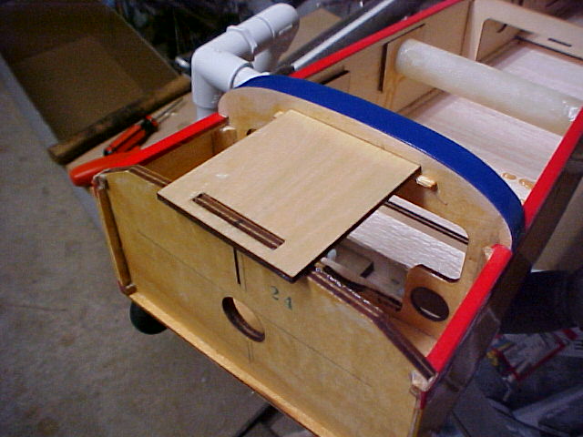

Hey all - got the kit in the mail today - going to post a few pics and observations. (My camera sucks - hopefully Santa might hook me up...)
It was packaged well, no damage due to shipping. Everything is in the kit that is supposed to be there.
Firewall is notched like some of the Seagull planes - that would allow a standard muffler to be used when engine is mounted on it's side. Saving you $35 on a pitts.
Covering is probably chinacote - but is applied very well - hardly any wrinkles or bubbles that need to be ironed out. the Cub yellow is semi-transparent - you can see woodgrain through it. I'll go over everything with an iron on med heat before it flies.

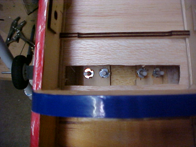

Wings are balsa sheeted, foam cored. Plug-in style with an aluminum wing tube. The fuse and wings both have a fiberglass sleeve for the tube to slide into. One thing I'm not sure if I like is the wing bolt - they want you to tighten a bolt through the upper wing panel to tighten on the wing tube. I would much rather have a bolt that goes through the fuse wall into a blind nut or something.
Before I cut the covering to allow the wing bolt to slide in, I may have one of the giant scale guys in our club take a look at modding the wings for a bolt. The only hesitation is that the root rib on the wings appears to be 1/8th" balsa, and realatively soft at that.
also - the anti rotation pin setup is a little different than I have seen before - pay attention to the picture of the hardware - the anti-rotation pin assemblies bolt into the fuse from the inside - and they are adjustible to allow incidence to be tweaked.
the rest of the hardware needed to complete the plane is included - the wheels are 2.5" generic foam models - light, but I hate how a foam wheel will lose shape if it sits on them for too long. I have a pair of sullivan skylites laying around I thik I'll substitute.

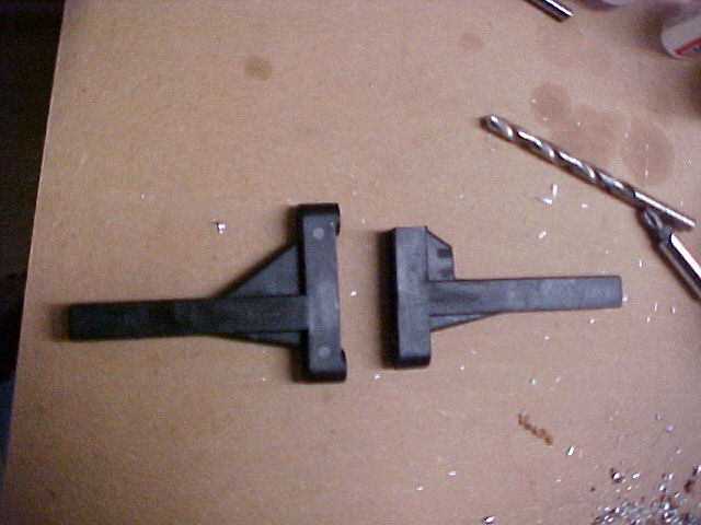

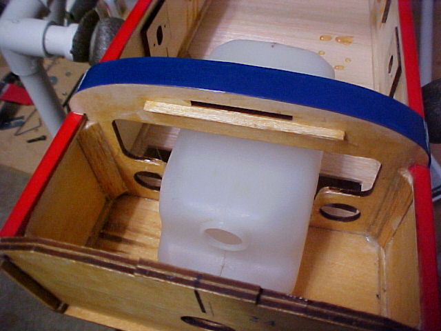

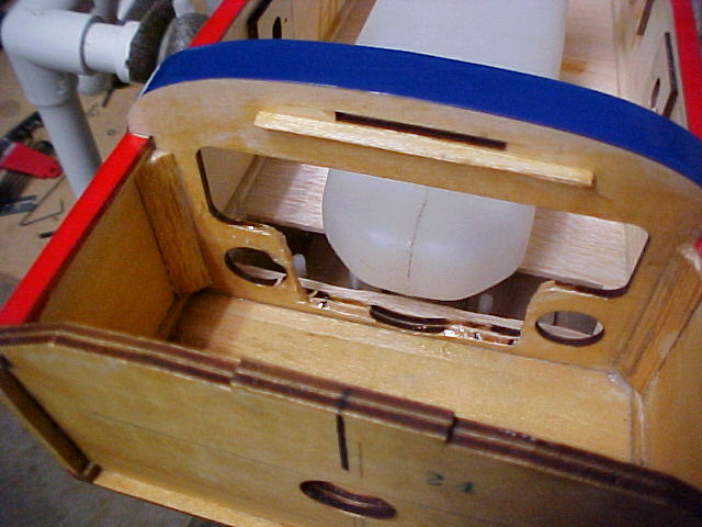

The landing gear legs are 2 piece, and thick - heavy too. The fuel tank is a smallish 320cc tank - about 11 oz - I'm going to try to get a 14oz I have into it if possible.
Tail sections are conventional. The rudder and elevators are stick-built, while the horiz and vertical stabs are solid 1/4" balsa. I'm going to install a set of flying wires I think. All control surfaces are pre-hinged on one side with CA hinges. I might go to the trouble of cutting them and installing pivot style hinge - but most likely not. Control surfaces are generous - not super 3D sized, but larger than I have seen on other planes.
The tailwheel assembly just looks downright flimsy. I have a sullivan 60-90 size tailwheel I will install - the fuse does have a layer of lite ply at the tailwheel mount as a hardpoint.
The ailerons have a lite ply hardpoint in them too for secure control horn installation. The stock control horn assemblies are pretty nice looking - similar to the dubro 867 in function, but with a more conventional plastic base. I have a few sets of the dubro's laying around that I think I'm going to install. I think the supplied horns are fine - I just like the dubro stuff, and already have it. The stock pushrods seem heavy to me - might just be my mind playing tricks on me there.

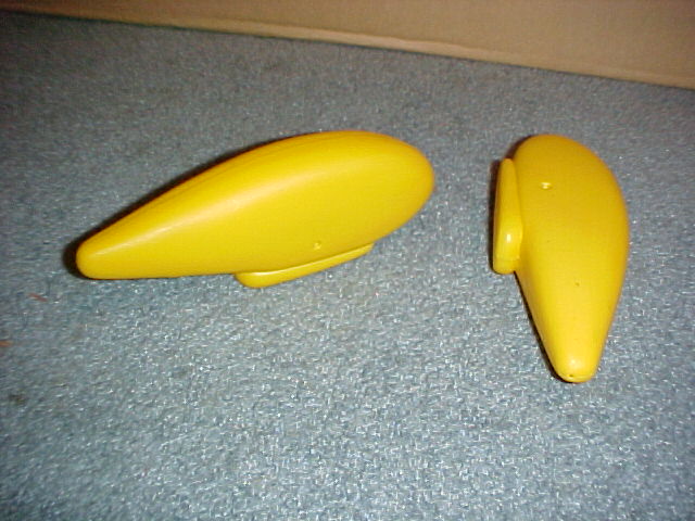

The fiberglass cowl is nicely painted, and almost matches the colors perfectly. The wheelpants are a joke - they are plastic - and not ABS plastic - they seem more like a cheap dog's toy, made out of a flexible plastic. I doubt I'll use them. I fly off grass so I may not put any pants on it - but if I do - I like buying the fiberglass pants from the U Can Do series - usually less than $18 a pair from Tower. I think the ones from the .60 would fit this plane well.
Motormount is included - although you have to line up and drill the firewall. Not something I normally see on an ARF. Also included is a white 2.5" spinner - it doesn't really match the plane, and the opening ring on the cowl is 2.75" in diameter. 3" would look less out of place than a 2.5" if you can't find a 2.75". The included 2.5" would still perform fine - it's all an asthetics thing.
Of all the hardware - at first inspection, only the tailwheel bracket, and the wheelpants don't pass the test if I had to fly the plane straight out of the box. (tailwheel bracket might work if flying off a paved runway all the time).

There are no markings on the box, instruction pamphlet or kit itself that gives any hint to it's origin. No country of origin info, no manufacurers R/N #, no copyright info, no trademarks - not a single thing to hint as to where this kit came from.
The instructions are a joke - they show servo installation in the wing - the servo hole is rotated 90 degrees to the opening in my wing. Not that it makes a difference, but it seems that this kit is something that has evolved to a 2nd Gen wing somewhere along the line.
It shows where to put the incidence adjusters, but not how to use them properly - I figured it out by looking at it all for a minute, but not everyone may be as quick to catch on. And not everyone knows how to properly set up wing incidence, or how important it is on a plane that can potentially have 3/8" of difference between one wing and the other.
Also - on the section that shows sliding the wing onto the wing tube - there is a warning that says:
"!!Warning!! Ensure that the two wing halves are securely glued together."
Obviously that shouldn't pertain to a plug-in wing model - but heck - not everyone may have the experience to know better.
control horn installation steps don't stress the importance of lining the clevis hole up with the hinge line to avoid offset. Fuel tank assembly shows setting tank up with 2 vent lines - but never tells you where the extra line should go.
The elevator pushrod setup is a split pushrod going to each elevator half - but there is absolutely no description of how to rig all of that up properly. No pushrod installation for rudder is depicted as well. No in depth radio installation, battery, switch - none of that.
It does have control throws suggested - all is in metric, 25mm up and 25mm down on alierons - which I come up with almost one inch either direction? That seems extreme to me for normal flight. Elevator is listed at 40mm up and 40mm down - or 1.6 inches each direction - again I think that's a lot of throw. Rudder is listed at 55mm left and 55MM right - or 2.16" each way. Until I'm sitting there eyeballing it - I think I'm going to go with something a lot more tame for my low rates for maiden. CG is listed between 105 to 124mm (4.1" to 4.9").

Spent some time at a friend's shop last night - we determined the wing panel was fine, but the fuse side was slightly bowed inward creating the gap at the wing root.
ended up adding a little balsa to the root and sanding down for a flush fit. We also talked about modding the wing so that the wing bolt will screw in through the fuse instead of through the hardpoint out in the wing. We're also not 100% sure that we're going to use the supplied incidence adjusters.
As soon as I buy a battery for his incidence meter, we're going to get moving on that. In the meantime, I'm going to start installing radio gear.
I test fit a DuBro 14oz tank and it should fit with only slight trimming of one former.
I will post some pics later.

Freak Louisiana weather kicked in yesterday- Beautiful 83 degree day, with 20-25mph winds all day. Since I didn't want to deal with the wind, I decided to get some work done on this edge. (Of course today it's back into the lower 50's just like 2 days ago.)
Few little things I changed - I installed some DuBro 5/32 axles for the LG - I just don't like the "bolt through the LG" axle setup on any model. When tightening the 4mm bolts that held the LG halves to the fuse, one of the blind nuts stripped out. I knocked all 4 stock blinds out, and replaced with 1/4-20 blinds, and nylon bolts. I had to cut through the sheeting in the fuse radio compartment to get access to the blinds and LG block. LG block looks sturdy, and is 2 pieces. Good amounts of epoxy visible on all.
I'm going to try internal antenna routing down the fuse and out at the tail - I took a scrap piece of Ny-rod and fed it through the hardwood piece in front of the tailwheel assembly I have installed. My earlier concerns with the supplied tailwheel bracketry might have been a little harsh - I'm going to actually use the supplied parts on a different kit I'm scratchbuilding.
You can compare the picure I posted a few posts back of the F1 former and the pics below to see how much sanding I needed to get the DuBro 14oz tank to fit - it wasn't much hassle at all, and should give some longer runtimes for little weight gain.
The majority of my work was surrounding the motormounts - I really want to buy a Saito 100 or the new 125 in the near future, and it might end up in this airframe. It happens that I have a friend's 100 sitting in my shop that I can use to set the plane up with. Comparing the 100 to my OS 61FX I was surprised to find that they have almost exactly the same width between mounting beams, and the drive washers are maybe 2mm different when the mounting lugs are lined up. The 100 should truly be plug and play if I upgrade from the 61FX. The only issue is that the cowl on this plane can't easily be adjusted forward - you really only have about 3/16 inch of fore/aft adjustibility on the fuselage. with the cowl set on the plane I was measuring just over 4.5" from firewall to the nose of the cowl. With the 100 sitting in the stock motormount, the drive washer was almost 5" from the firewall.
To modify the motormounts to clear the Saito's carb/needle, I had to cut the top lug off, and some of the stress webbing out. You can see in the pic how much I had to cut to clear the 100's carb throttle arm. I also ground off the tabs on the mount that would have been the part of the mount actually touching the firewall. I'm sure that was designed to transmit less vibration to the firewall, but I had to get another 1/16 inch whereever I could to move the engine closer to the firewall.
