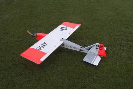

Do what I did and change it to something you CAN see! The underside of the plane is Corsiar blue with yellow wing tips. The Orange is Ultracote neon red. You can see this one from the next county!
