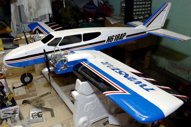

I'm in the final stages of building my Twinstar and I've noticed the left engine has noticeably more downthrust than the right. The nacelles are installed properly as are the motormounts, the firewalls have different downthrust angles. Is this normal??

No. Use washers behind the engine mount to raise the excessive one to match the other.

Mine's the same way, Rob. It's my first twin and it gets rave reviews for ease of engine-out flying, so I figured it was designed that way. I left it as is.

You can notice the left engine downthrust:

I'll try a different method of inserting the photo.
No, I haven't flown it yet. I was following the TwinStar threads on these forums before I bought mine and don't remember hearing any mention of it. I figured if it was a mistake or manufacturing defect, someone would have mentioned it. Same if it created a problem in flight....
I HOPE it's OK like that!

After looking at the photo I posted and thinking it actually looked like the RIGHT engine had more downthrust, I went down to the shop and very carefully looked things over. My engines have identical downthrust.
Holding up the wing and looking down the LE will give you a good indication of the real deal. Your props have to be at exactly the same position or things will look out of whack....
