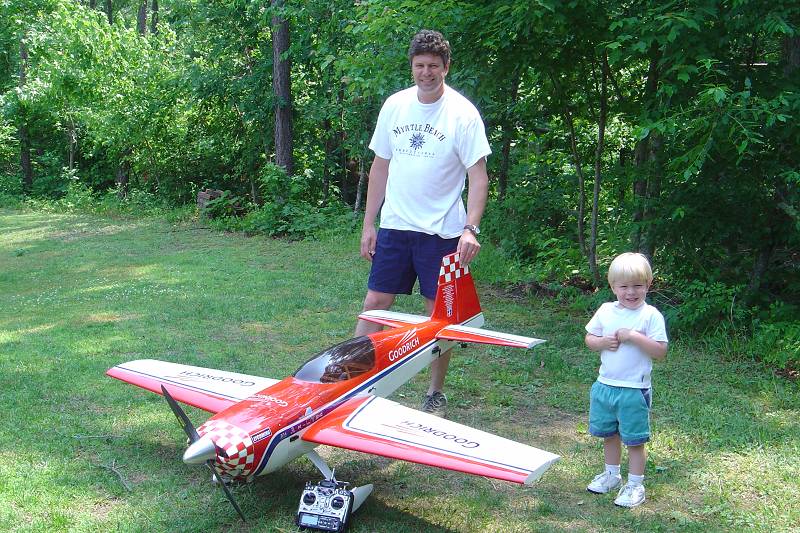

DA50R set it and forget it....you wont regret it.
I'll second that comment!
