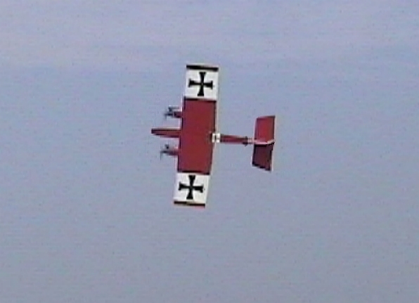

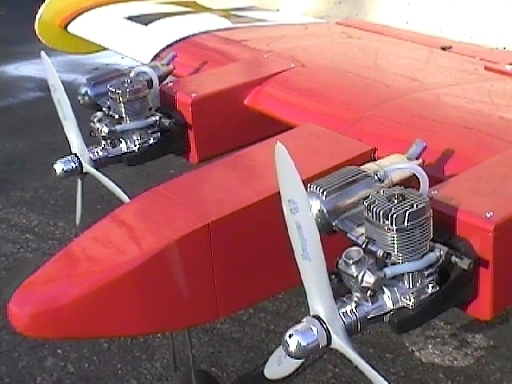

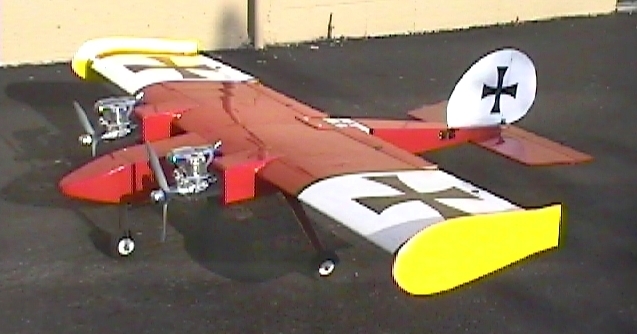

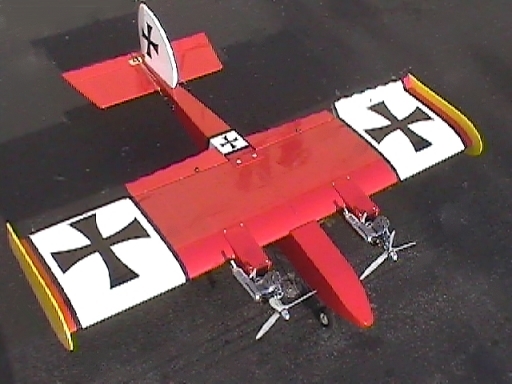

Something to think about is maybe doing up a Great Planes
60 size stick... Attached is a pic of one I did and it flyes like
a dream.. The three bladed props were ONLY for looks as
it was made with more thna enough room for bigger props..
Isn't a rocketship,, but is a great flying plane..
If you want to do a Twinstar then I would highly suggest staying
with motors in the .30/.35 range for good all around flyability...
If you want a plane for the .46FX's,, do the Stick thing...
