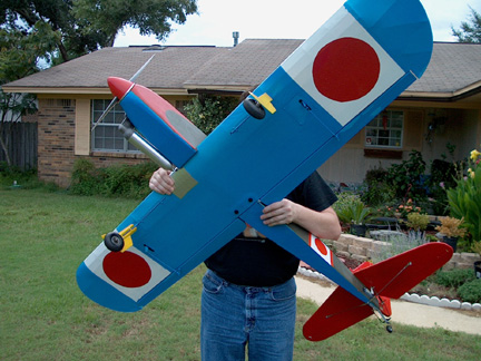

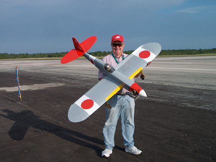

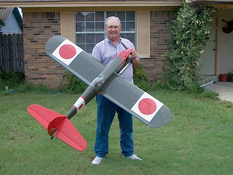

I've had 2 4*60s, both were bashed into a Kawasaki Tony, but with shorter wings. Both flew great.
I would definitely cut off 1 rib each side. For rounded wing tips, I cut off 2 ribs and added about 1 1/2 back with the round tips.
It needs more rudder, at least an inch. It can also use more elevator, but the rudder is woefully small. I moved the servos to the rear.

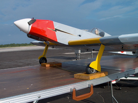

I moved the gear to the wings. Straight as an arrow take off with no rudder correction. I used ply doublers on the forward half of 3 ribs and installed landing gear blocks. I also used 3/16 wire.
Both my planes had .91s. The first had an OS .91FX. The stab came off and totaled the plane. My second had a Magnum .91XLS with an Ultra Thrust muffler. Unlimited vertical. Rotate on take off and go up forever.
