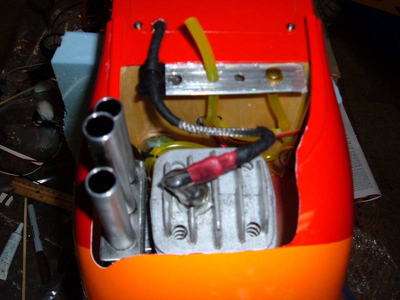

OK results.
DA-50R Menz 23x8 Broken in 50:1 AMsoil Dominator,
Stock muffler,,,,7010 max Happy at 6930 ...29lbs 1oz thrust.
Slimline Piits tips uncut,......6510 max, Happy at 6450 no thrust reading , why bother. Fits in cowl though.
BENNETT BUILT THREE PIPE.........6710 max Happy at 6630...26lbs 4oz. Fits in cowl just like the FPE in the manual.
There is no way I am giving up 3lbs let alone 4 or more with the Pitts. Forget it.
Cut cowl here I come.
I thought about making an add-on cover for the muffler attached to the cowl. Or Anodizing the muffler RED. Dont know what Anodiizing would do to the heat dissapation of the muffler.
Mine will just be UGLY LOUD BEASTLY BIPE. 29lbs of thrust is fun. I flew the Test Yak (my KMP) at 18lbs 2oz. With 29lbs of thrust.
So 17lbs and the stock muffler will be just what the doctor ordered.
Anyone got a good picture of what the plane looks like with the cowl cut for a DA Stock muffler??
There was one pic but it wasn;t very clear . Dremel in hand.

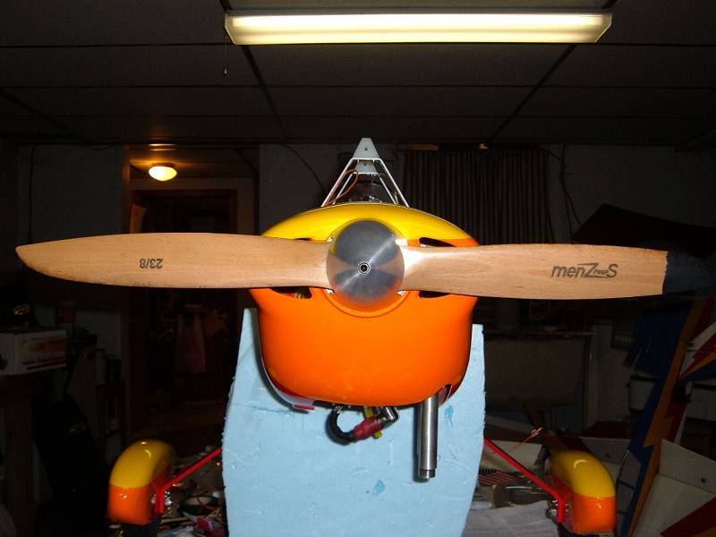

Motor mounted. Bennett Muffler wil lbe tested first, then I will cut the cowl if it needs more power with the stock muffler.
Balllinks on half of every linkage rod on the plane, Ailerons and Elevators. Just to keep them from binding.
I dorked the tail glue on..and got it on with a little twist to one side. [:@][:@]
I corrected it somewhat, but it may still be noticable.
So far so good.
Red loctite on Tail braces , and linkages. Also went Ball-link on Rudder servo arm.

My Da is going to a clean install. Just a little cutting for the Spark Plug and a slot for the Bennett muffler.....it will be loud.

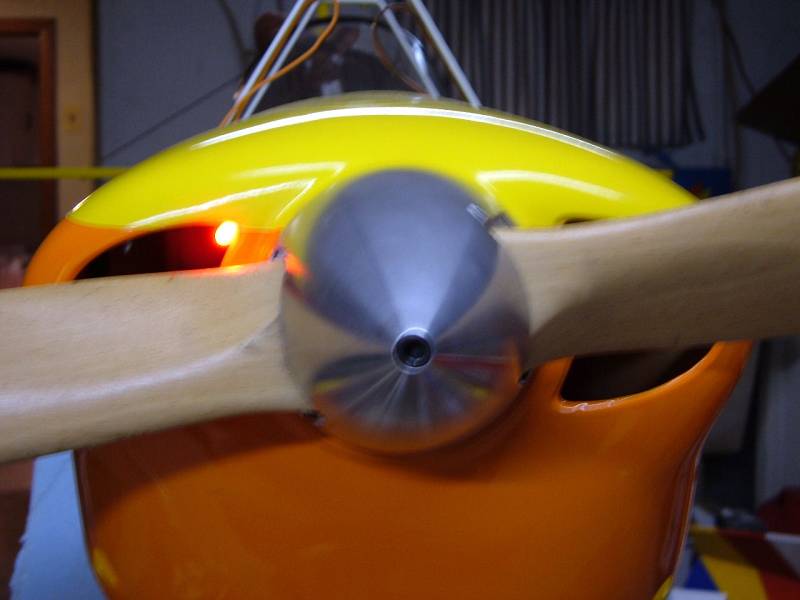

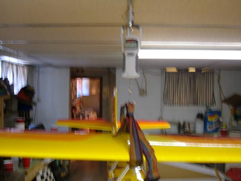

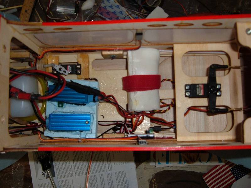

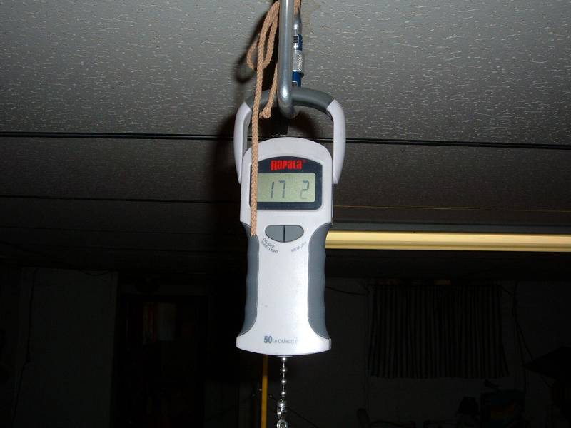

OK ...RTF ......16lbs 9oz.
DA-50
Bennett 3 pipe muffler.
Vrtech 3" Spinner
MenzS 23x8 wood.
16oz Du-bro tank.
Stock hardware except for 6 ballinks in place of clevis'.
Jr 649
2 Fromeco Regs
1 Fromeco 2400 RCV.
1 TP1320 Li-po on igniton.
Smart-fly Opti-kill
Failsafe pin sw on reg.
Deans connectors through-out.
5 HS-5945
1 HS-225BB
The weight picture is with the 9oz strap!!
The Light in the cowl is from the Opti-Kill.
Rocky , well , he flies the plane.

Here is the blurry shot i did not include of the plane and scale, not sure if you can read the LCD or not.

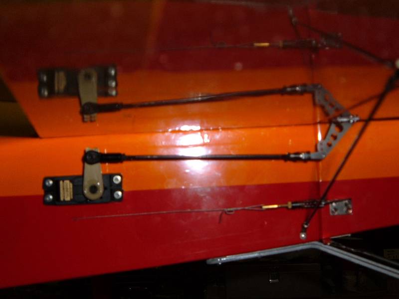

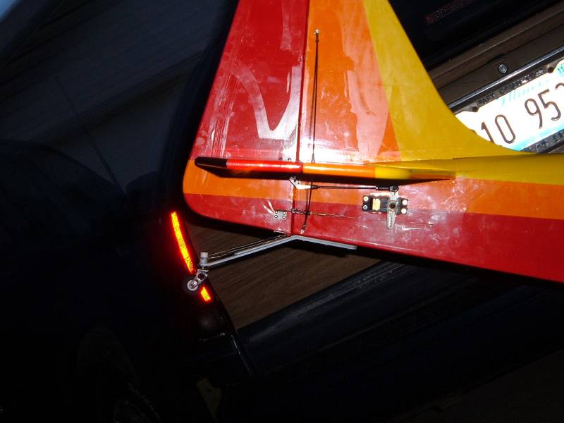

Maiden Successful, very successful.
I am CG'ed at 4 7/8 inches. Look at the Elevator picture I took whilst unloading last nite. I turned on the radio, looked at the elevator trim....very interesting. It nneded DOWN trim ...so is it tail heavy?? It flew well. It was a VERY windy Day, and I had to push the nose down to get her to land.
Flew great , but is was a bumpy ride, and I couldn't get a real good feel for how stable it is , although it was able to fly pretty damn slow. Just, bumpy , wiggly, 14-16 mph winds.
Incidence set to 0. Lateral balance, a little heavy on the right. I am not going to adjust her laterally unti lthe smoke system is in.
The Bennett muffler fits , but I only get 6510 on the 23 x 8 prop on the ground. I am going to try the 22 x 8 , on a calm day, and decide if I should butcher the cowl for the stock DA muffler. The thought of losing 3lbs+ of thrust without the Stock muffler is tough to swallow.
The cowl costs 36 bucks, so maybe with a little creativity, some glass and chicken wire, I can re-form the cowl to cover the Stocker. It really is a pretty cowl, the paint is tough, I have handled and taped and banged her around already, and not even a single paint chip. I dont think I will be able to duplicate the paint job. At least not a s well. this paint is hardend well, like baked.
Here are some pics.
