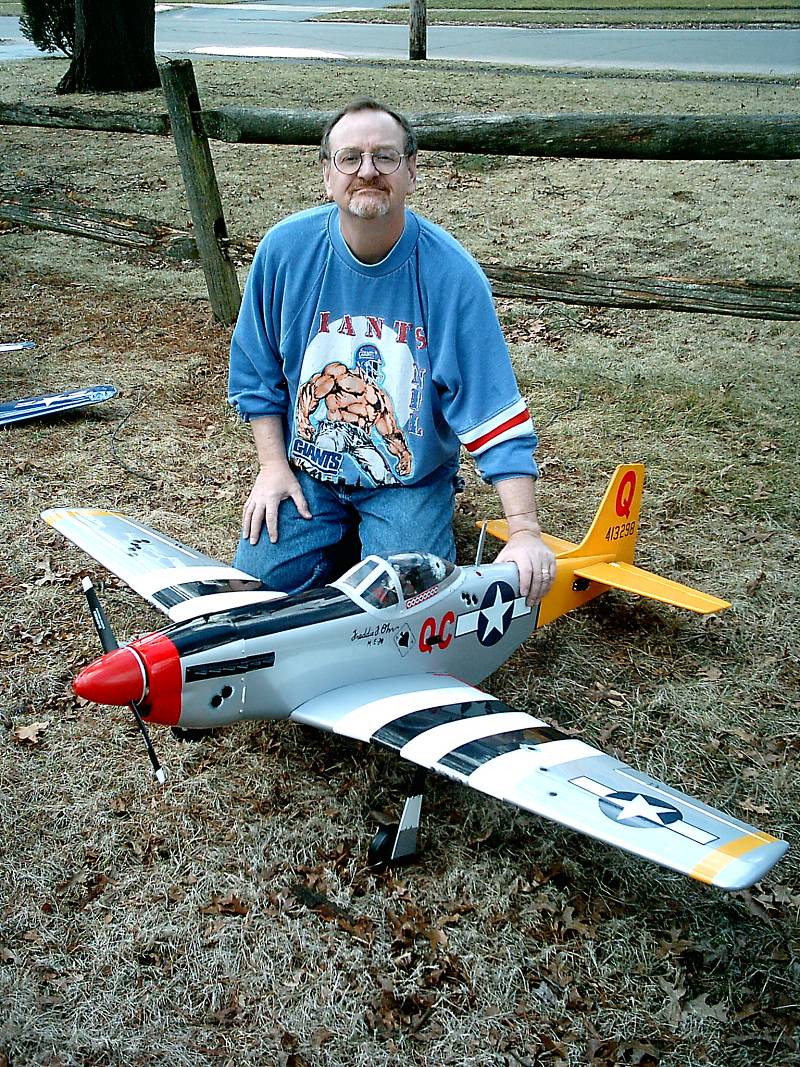

I had one of these planes which are basically just a knock off of the Hangar 9 60 size Mustangs. Mine flew just as you said. No bad habits and no tendency to stall at low speed. It glides nice on landings. I didn't bother with Robart retracts, although I did order a set of Hangar 9 retracts and replaced the stock retracts with them and didn't have any problem. The Hangar 9 units drop right in. As for the mounting the motor, I thnk I just lined up the engine with the hole on the firewall and that worked out ok. The one problem I had with the plane was when the elevator horn pulled out of the elevator. Upon closer examination, the wood they use for the elevator was very soft and weak. I reenforced it with some harder wood and flew the plane for many months with no problems. It finally met it's demise on a deadstick at low altitude when I tried to turn it back to the field and lost too much airspeed and cartwheeled it into the ground. Since I had a Hangar 9 mustang waiting in the wings, I just went ahead and built that rather than rebuilding the evergreen model.
This is a picture of my evergreen mustang when it was still new.

Thanks for the feedback on the motor mount. I will give that a try and based on your pic, your cowl looks great. Sorry about your plane, it looked real nice. I hope when I'm done with mine it looks like yours. Also, I think I will put some thin CA in the holes for all my control horns to beef them up.
