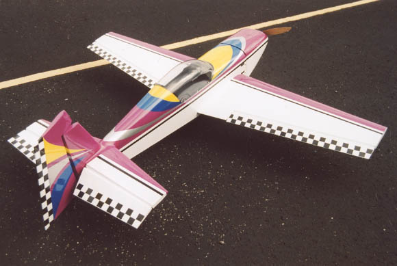

Thanks for the compliments on the look of my Extra. I really liked the plane but I guess in the world of ARFs, we still seek a dash of our own look to the plane. While there are not a lot of these around here, I did want it to look different - just in case.
As for glassing the wing, it's only along the seam where the halves join. It's just for extra strength and to help keep the halves from popping apart at the epoxy. But... it depends on how hard you plan on flying it and how much force you plan on putting on the wing. Just a precaution I took and it takes very little effort. Just don't slice the balsa when you take the covering off the wing - about 2" or 3" or so each side of the center seam - then lay the glass down. As for evidence of the stock not holding... nope, not that I know of and I wasn't going to be the case by which everyone else decided to then glass....
So far the plane is great but still getting familiar with it and its characteristics. Oh, bought new main wheels today. The stock ones are shot and the rims actually broke... and yes that's only about 12 flights. Stock foam wheels shouldn't have even been a consideration on Sig's part due to a lot of people having paved runways.

P.S. Oh, and regarding my scheme... I WISH the purple would have been the color you always see in the magazines which is more like the Deep Metallic Plumb Monokote rather than this lighter Smoke Purple Ultracote.
I was a bit disappointed to see that in person. Considered stripping it, but decided not to. Had already spent enough time on it and didn't want to repaint the cowl.

Well, smartwork, it sure is a beautiful airplane. I was curious about the wing because I had heard one report of the wing folding....but that could be many things other than the inherent design, such as incorrectly joining the wing. Mine is not glassed, and I do occasionally put the airplane in stressfull maneuvers. If I had a 2.4 gasser, I'd defenitley consider glassing. As long as I have a 1.8, though, I'm just going to keep it light as possible.

Hey there, tool -
Just to clarify, I only glassed the seam... not the entire wing. So we're only talking about 2 strips of glass that are 5-6" wide and what... maybe 15" long. Those with a small amount of resin will probably be one of the lightest things you'll add to the plane.
