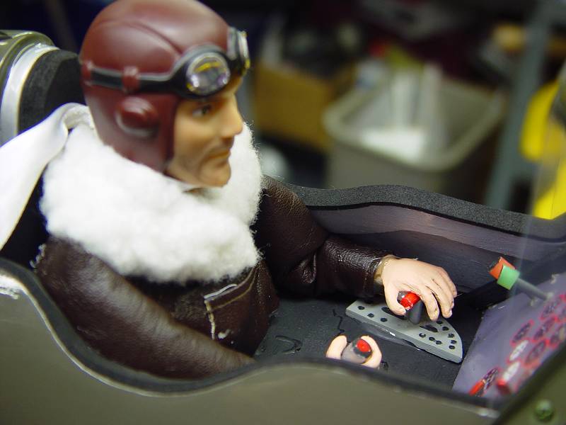

Here's mine with the YS 1.20 - real good power with 3 blade 15x8 and no extra weight needed.
