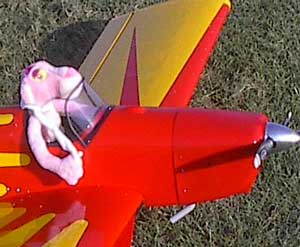

Here is my pilot of choice, this plane looks so dumb unmanned! With the extra room in the plane I hooked up a sevro to his arm so he waves on the low passes.
Gordon
