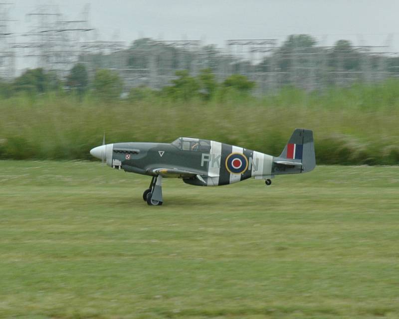

Hello, I want to draw panel lines and other detail markings on my H9 P-51 Mustang .60.
I have never done this before. I purchased a Top Flight Panel line marker and the Top Flight
rivet and panel line template.
I guess my main question is if I need to clear coat the plane after I finish all the markings?
There are no detailed intructions with the marker or suggestions.
By the way this Mustang is Electric, so I do not have to worry about the effects of fuel.

If the covering is plastic (MonoKote or similar), you'll need to clearcoat the panel lines, or they'll smear and rub off from handling. You can use Top Flite LustreCote, but just mist the first couple of coats. If you apply it too heavily, the panel lines will run. If you use Flat clear, it will dull the gloss of the cover, which IMO looks better on a warbird, or you can use the gloss clearcoat .

I'm in the midst of trying to figure out how to panel line my new KMP Spitty. I don't want to make a huge project out of this as my partially started Yellow spit will be jealous. I was thinking to run some tape where the line goes, run a pencil down the edge and then clear coat it in. I think those pens tend to be too black and look like what they are, black lines drawn on a surface. Using something a little gray simulates darkness of the line but is not so bold it looks fake. Though a pencil would be hard to use on regular monokote !
S1
Oh yeah, here's my TF MKIII Arf
