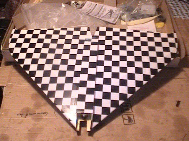

I was showing this one to my wife. I'm thinking of sending back the Speedy Bee I just got and getting this one.
Anyone got pics of the bottom to post?

No pic's Salty... my Kid's broke my digi camera[:@]
Anyway... the bottom is Black and White checkerboard, it's a nice contrast.
