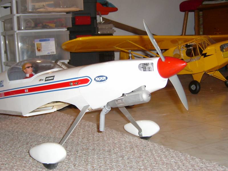

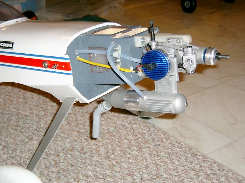

Hey guys,
I picked up one of these planes today. I just came up from the work shop after about 2 1/2 hours of working on it, and am very happy with how quickly and easily it is going together. I wish I would have checked this thread first. I think I would have made a U wire and eliminated a servo for the elevator. I was a little surprised that they have it all set up for 2 elevator servo's.
I am going with an OS .61 fx. I was a little concerned that might be overkill, but after reading through all of your posts, I am confident that the .61 is a good choice. Sounds like the extra wieght will be a positive and not a negative. I have a .61 in a hanger 9 twist, and find it to be a great running and powerful engine. The manual mentions a muffler extension. Did any of you guys using the 2 strokes need one of these? I think the muffler on the .61 sticks out a bit further anyway. Any advice on this would be appreciated.
I don't think I am going to reinforce the landing gear or undercarriage at this point. I usually wait until I rip the gear off once or twice before I do anything that would make as much sense as reinforcing the gear.
I included a couple of pictures of the .61 for those that are interested.

Got mine finished today. I managed to get it to balance out without adding any wieght. In order to accomplish this, I had to move the receiver battery back to just in front of the servo's. I made a removable balsa panel that I can insert from the wing opening. I am anxious to maiden it tomorrow. I will post a couple of pics of the finished product tomorrow.
Adam

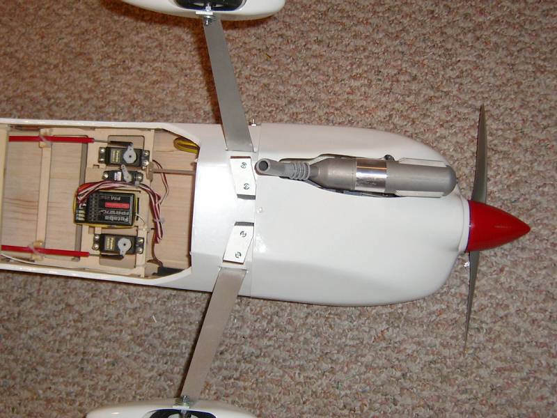

Here's Mine. I originally had a Magnum 52 in it. Flew well but the engine just wouldn't idle right. Since these pics were taken I put in a Magnum 40. Flies just as fast as the 52, plus is lighter. I run a 11-5 APC prop. I spent a little time cutting the bottom of the cowling to glove around the muffler just right. It looks good and is a slick little airplane. It does have a slight tail wag that seems to be a trademark of a lot of Seagull airplanes.

flyingvranch,
Your plane looks great. That is a really nice job you did of cutting out around the cowl. I am happy with the way mine turned out, but it is not as close as yours. I am surprised that the .40 is enough power for you. I suppose it is quite a bit lighter, so that helps a lot. A .61 is overkill. I fly it at half throttle most of the time. I like the extra power for vertical climbs mostly. I bet the added fuel economy is nice. How long do you get out of the stock tank?
Adam
