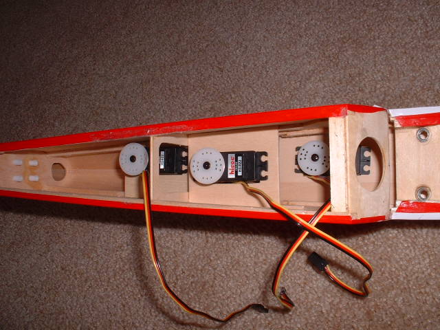

Anyone done the CG on a Magic Extra yet?
I'm using a TT Pro .46 and I'm worried about coming out tail heavy.
Considering all the weight aft of the TE, I'm thinking about waiting until the last minute to drill the engine mounts.

RLT55, it should be fine w/the TT46 on the nose. Mine actually took 2 1/2oz tail weight after I moved the batt back to get it to fly like I like!!

Are you using the TT .46 Pro (Or an engine that weights about the same)? What size/weight battery pack did you use?
I was thinking of using a smaller servo for the throttle control. (the HS81mg). Might as well forget that if the tail is going to be light.
Big question: How does it fly?

I am using a tt42gp(15oz), my batt is a 6.2v brick pack (9oz), and I am using Hitec HS625MG all the way around, except throttle (hs422). And it flies great!! No complaints in any department. With the tt42gp it pulls vertical forever, so I couldn't imagine it with the 46pro! Should be a great little 3d'n machine....
