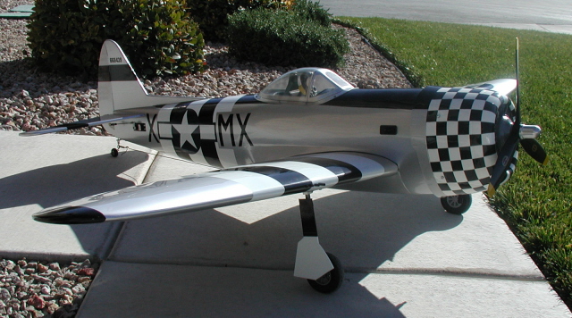

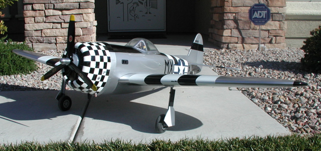

Old 02-04-2006 | 01:17 AM
Hellcat716's Avatar
Joined: Sep 2003
Posts: 1,266
From: Las Vegas, NV
Default RE: Engine for Hangar 9 60 size P-47
Saito 100. No additional weight required. Fuel tank in stock location. Engine runs perfect. Plenty of power for this model.
