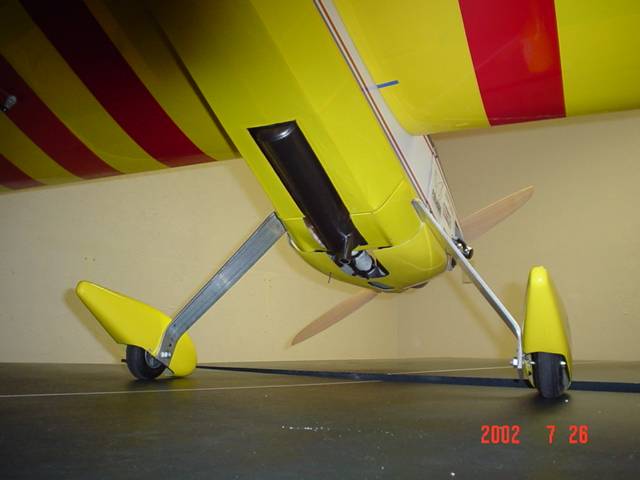

I dont think a twin will fit without most of the heads sticking out the sides. Below is the only pic I have handy of mine with the ZDZ 60

I glued 2 1/4" dowels to the landing gear plate that were long enough to just touch the bottom of the fairing, then drilled through the top and installed two button head sheet metal screws to hold it on. Lots of flights and still holding strong. Thow away the axels as fast as you can or they will end up giving you a spectacular ground loop followed by (at the very least) scuffed wing tips and a good temper tantrum. Three out of three planes in the club have lost an axel. I have tried the balance up-right and upside down and it does not seem to make a difference on the balance machine.

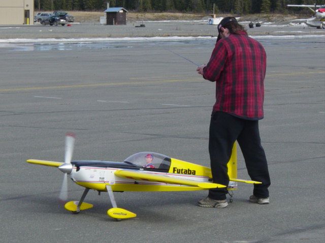

I did figure out that while most say this plane is not real solid in the routines but is great for 3D, it can be VERY solid in the routines. All you have to do is drop the throw way down and get rid of some of the expo. I now have six flight modes for mine. Three are for IMAC and are for different parts of the routine and then I have the freestyle, bit more freestyle then all out much as you can get ...... It REALLY made a world of difference on this plane and has made it a dream to fly. I had always stopped halfway through the trimming chart and figured aww heck thats good enough.... Take the time to really dial this plane in and you wont be disappointed.
I also got a 5735 to put on the rudder pull pull so I can cut down on the size of the ignition battery and save a little weight there, and it should also move the CG a little more forward and make the routine even better. I added another deg. of right so now I am at 3 deg and it took all of the left pull out on the up lines and it tracks much better through a loop. It did not affect the hover or have any other negative impacts.

Yep, its a K&S. I used a 22X10 for breakin then had a Menz 24 X 10 till last week and I picked up a Beila sp? 24 X 10. Dont even waste your money on a wood prop..... The difference is incredible going to the carbon fiber in terms of smooth idle and better power. The tail feathers no longer vibrate at an idle and the prop tips track straight as an arrow. Besides I think it looks better too.
I will be home on the 16ht and am moving the rudder servo up and am going to see if I can go to duralights etc. to lighten it up some more depending on the new CG location. At the arm the rudder servo is now (in the tail) the 2 oz servo should be worth ~ 12 oz in the nose, therefore I should be able to lighten it up a good bit. I would plan on putting the rudder servo under the canopy and save yourself some heartburn later.
Just checkout the prop disc it looks darn good comming at you, and I LOVE the sound of the pipe when compared to my other edge that had the pitts muffler.
