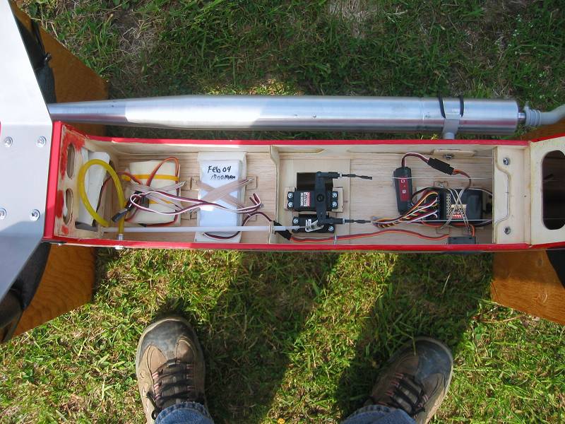

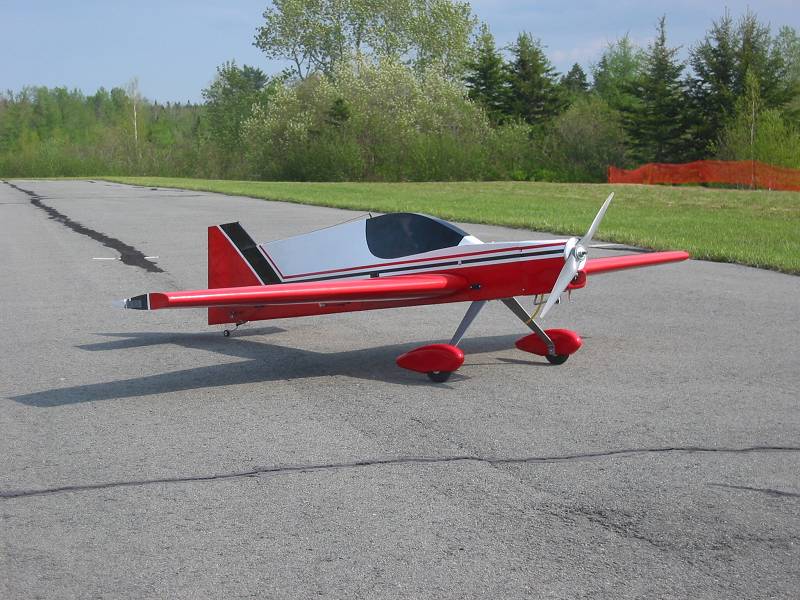

Here you go. This is mine, MVVS 26cc gasser c/w tuned pipe. Very nice flyer but go for a lighter engine combo. An OS 160 or YS 140 would be nice.

Thanks for the the response guys, and Don a YS 140 is the motor I was looking at for this plane just today in fact. I guess that answers the engine question. I would also like to know if there is a pull pull set up for both the rudder and elevator. The 40 comes with a pull pull for the rudder only, and they make it somewhat hard to set the geometry up in such a narrow fuselage. I hope the 120 is a little easier. Again thanks for the feedback and the pictures.

It has 2 - elv. servos in the rear and a pull / pull rudder ( as seen in pic. ) I had no problems setting it up at all, very easy. I have 9001's on the elv. ( plenty ) a 5945 dig. MG on the rudder ( plenty ) but I started out with 9202's on the ail. and stripped one in short order. I then put in 5625's which made an awesome difference in control. This was the first time I pulled analog servos and replaced them with digitals, I'll never buy analog servos again.
IMHO the YS 140 would be perfect. You have to mount the engine upright [:'(] or inverted and the YS works well inverted. I have a 140 in a pattern plane and I might just try it next summer in the BN120. You can only squeeze in a 16 oz. tank but that should be OK with some throttle management.
The plane should come out at 11 - 11.5 with a YS or OS. Mine is 13.25 with the gasser and it is just too much although the airframe carries it well and even at that weight this plane can be flown at about 5 mph without stalling. KE is incredible using about 25% rudder and no elv. or ail. correction needed. If there is any problem with this plane it would be that it floats forever and requires great precision in landing if you have a small strip ( ours is only 350' paved ) but it might as well be a postage stamp with this plane. It could be from the extra weight I carry but I have an 18" prop and an engine that will idle all day at 1500 rpm's. I'm used to it since I also fly pattern planes but I prefer "draggy" sport planes, like bipes . It's not a big problem, just something to keep in mind.

Don, thanks a bunch for all the info and the pictures of your plane. My BN 40 is also a floater, so what you said does not surprise me about the landing habits of this bird. I agree with you on the YS 140 for the power. I have a YS 63 and I think that they make fantastic power and easy to tune. I know that the BN is a fairly dated plane, but they are new to me, and besides no one around here is flying them at my field. I never expected the plane to fly 3D, and I only wish I had the skills to fly 3D...maybe someday.
