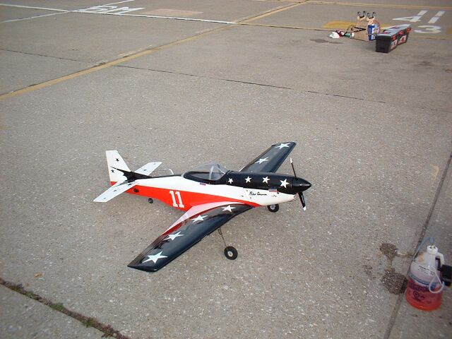

Hi Jeeps.. I think the 100 would be a good choise. I had to add 4 ozs to the noise of mine.. and yes I have enough power . The TT 91 is a beast.

Its not quite done as yet as you see no pilot and struts R missing. But the retracts are in.
