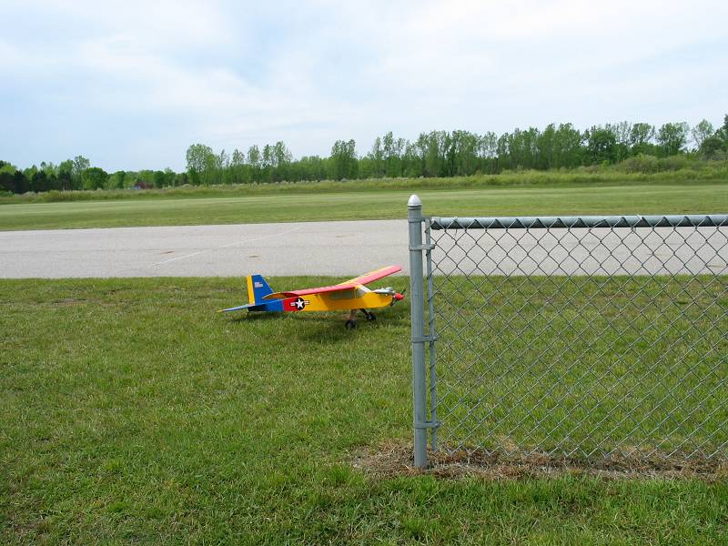

I built this LT-40 from a kit as my first plane. I made it a tail dragger - IMO the ground handling isn't bad at all. I have a OS 50 SX on it which is a great engine but almost too much power for this plane. As others have said it is a great slow flying plane. I usually fly at 1/2 throttle.
