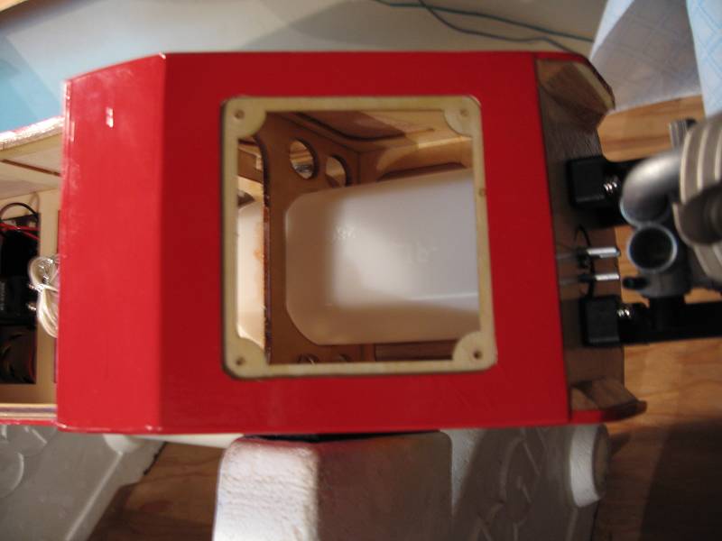

OMG!! Check out the level of prefab here...
looks like they have a plywood block sandwiched in the fiberglass with blind nuts installed.

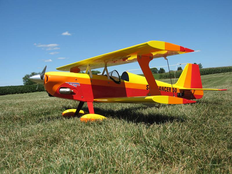

I put an OS 65la in mine, flies great! You will have a lot of fun with it. I had trouble taxi-ing mine, but I fly off grass, had to adjust the tail wheel, now no troubles. Also you might want to put a little thread locker on the turnbuckels on the pull-pull system, had mine come undone at the servo. All said and done, real nice plane.

I just finished my Sundancer 50 - last week tried to fly, but kept nosing over. I double checked the CG and the balance point was right on 3 1/4 inches. Also trying to fly off grass - wet grass then, any ideas - balance point per manual working for everyone? Grass field the problem, maybe even pilot error
Old 10-21-2007 | 12:36 AM
Joined: Jul 2004
Posts: 109
From: Thomson, IL
Default RE: Sig Sundancer 50 Build
k7pa, I ended up taking the wheel pants off, putting bigger wheels on, and bending the tail-wheel arm up towards the fuselage. Like yours, mine balanced properly. Since making the changes, I have had no problems taxi-ing. The plane still looks good without the wheel pants. Before making the changes I tried about everything I could think of, but it kept nosing over, even with maximun deflection on the elevator.

I fly off grass & still have the wheel pants on. When I start to taxi I goose the throttle a little. Once rolling I keep in up elevator until I get it rolling for takeoff. I haven't had any nose overs since using this method. Give it a try if you haven't already. I also had to bend the tail wheel assembly towards the fuse.

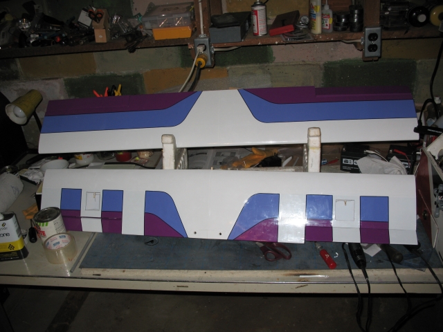

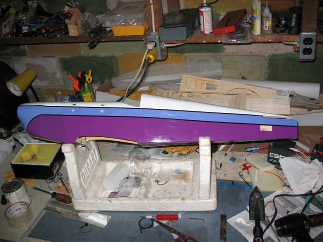

Well guys I found this at the LHS. I thought it was the yellow version but when I got it home I found out I had the purple one.
I've liked Sig airplanes and had good experiences with the Rascal. The Rascal was covered in Ultracote. This Sundancer is covered in AeroKote. I'm not impressed with AeroKote seems like Chinese covering to me. Low temp and doesn't stick or shrink as well as Monokote or Ultracote.
I did not like the same covering pattern on the bottom of the wing as the top. Nor did I like seeing the white plastic servo covers against the purple and blue colors. So I added 3" wide stripes out of Ultracote. I liked the 1/8" pin stripping on the fuse and added 1/16th " on the wings. What do you think?
The plastic servo covers will fit in the middle of the stripe. I'm also going to epoxy the bottom of the plastic servo covers with 1/64" ply. I had a problem with them deteriorating on the Rascal.
I don't have a .70 4 stroke and I hate the idea of a large 2 stroke muffler hanging out the side. I looked at the weight of the Magnum 91 verses the 70 and they are really close so it will be getting the 91 and a 13 ounce fuel tank.
