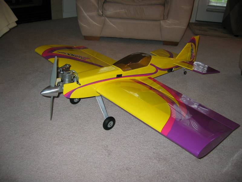

I have an Ultra stick 40 coming from the local shop, and I can't decide which powerplant to slap on the front of this bad boy. I know Hangar 9 reccomends either the Evolution 46 or the Saito .72, but the 82 is only 1oz more, and appears to have considerably more power. My only concern is, would the .82 have TOO MUCH power? I'm going to use the plane to practice what I've been doing on the simulator as far as hovering, torque rolls, harriers, etc. I also plan on doing the CROW mixing and quad flaps with single ailerons (since I only have 6 channels) although I'm sure I'll try quad ailerons with standard flaps at some point.
I also have a Hangar 9 Twist 40 that everybody reccomends the 82 for, so at least if I got the 82 and nuked the ultra stick, the Saito would still have a home.
Anybody try either of these combos? I'm sure either one will be awesome. But when spending 200-300 dollars on an engine, I want to make sure I make a very educated decision.
Also, a side note, the only difference between the std version and the Black Knight is the color, right?
Any help is appreciated.

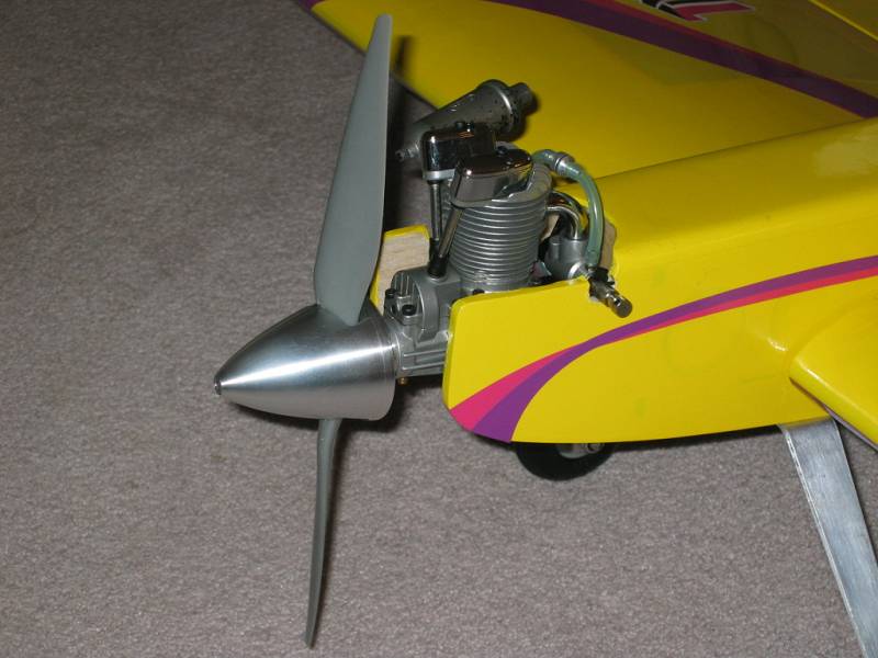

I have the saito 82 and love the engine. I am curently looking for a new home for it and have run into issues with prop clearance as you can only go so small. To do the 3d manuevers you will want to run something like a 15x4 which will probably hit the ground. The smallest prop they rec. is a 12x8 which this engine will really swing and be pretty fast flying and landing?
I am running a Saito .82 on an US 40 with an APC 14x4W prop. Bend the stock gear in a little bit for more prop clearance. With flaps deployed it will blast off the ground in just a few feet and go straight up out of sight. Overpowered?...yes...fun?...definately!

Alright so 82 it is!!! That's what I wanted to hear anyway
So I should probably start with like a 14x4 prop and just bend the gear to where it doesn't hit the ground?

I used the stock main gear with taller 2.5" foam wheels and bent the gear in slightly for a little more clearance. 3" wheels would probably work better. The APC 14x4W is a 3D prop and it produces gobs of thrust and will help keep the speed down. I've had mine for about a year and a half with well over 100 flights on it and never had a single problem. I had the US 60 (sold it to my brother) and in my opinion the 40 flies just as good if not better.

Flew my US40 quite a while with the Saito 72 (82 wasn't available yet). This combo was great with an APC 13 x 6. Had to add some tail weight to balance. No question - I would recommend the 82 over the 72.
The APC 14x4W willgive you exactly what you are asking for... moderate speed and plenty of thrust to pull out of a hover. As far as props go it's a trade off. If you want a lot of speed you gotta give up some thrust and vice versa. The US 40 is not a 3D plane and it's not a real fast plane. It's more a sport plane. It will do some very nice flat spins,loops, rolls, snaps etc. and with the crow flap setup it is a hoot to dive straight down and land at your feet. Knife edges are a little tricky. It handles the wind real well and is a real fun all around good flying plane. You'll like it.

You've got to be careful using the 14x4W with the Saito 82 because it can over rev the engine. Again, throttle management is needed. A 14x6 APC is a much better choice for the 82.

A tach will help you tune it on the ground but that prop is not enough for 82, it will "unload" in flight and overrev the engine. I would stick with a 15x4 or a 14x6.

15x4 will give you more static thrust, the 14x6 will give you more speed. You kind of have to decide which one flies the way you want to. I would start with the 15x4 but either prop is alot of prop and engine for this plane so take off will be short and direct, the 15x4 may help slow it down for landing.
You are going to have issues with ground clearance with the 15" prop unless you go with taller landing gear and 60 size landing gear won't look right on it. That's why I suggested the 14". The 14x4W is fine for the .82 if you stay out of the throttle on the down lines (and it will work with the stock gear). I've been running that combo for a year and a half on that plane and my engine has stayed together. But if you are worried about it go with the 14x6.
