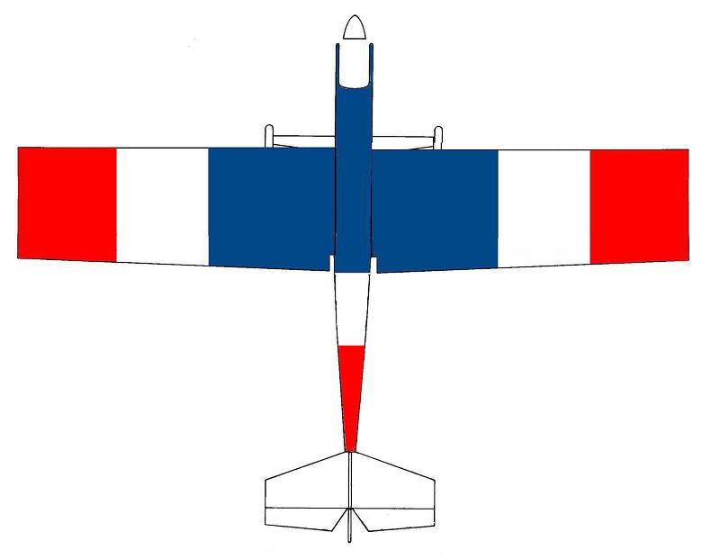

Couple of questions though. Anyone have any issues with orientation with this model as it is the same top and bottom as far as colour and pattern? What is it like to see in the sky?

I put 3 stripes on the bottom of each wing on the one I had. I ran a Saito .72 four stroke on it which weighs about 16 1/2 ounces. The 1100mah reciever battery went in the fuse near the tail to balance it with no additional weight. I can't comment on your engine choices since I have no experience with any of them. You will enjoy the plane it flies very well.
about the only time you could have orientation issues would be straight on (when it's flying towards you, because you're pretty much using the LG as your orientation. Other than that, just put a contrasting scheme & you'll be ok.

To help with the orientation issue I have covered the ailerons with bright orange, I might also put some strips on to help some more. I am always surprised when kit manufactures produce kits that have no visual aid in orientation on the colour schemes. I hate having to add colour to a model as I can't cover as well as the manufacturer

Place two or three large chordwise panels from a contrasting color (two or three rib bays per panel) per wing on the bottom using the "windex" technique (I divided each wing panel into thirds on my 4* - pic below) - will be easy to keep oriented and since it's on the bottom, the covering need not be perfect!
