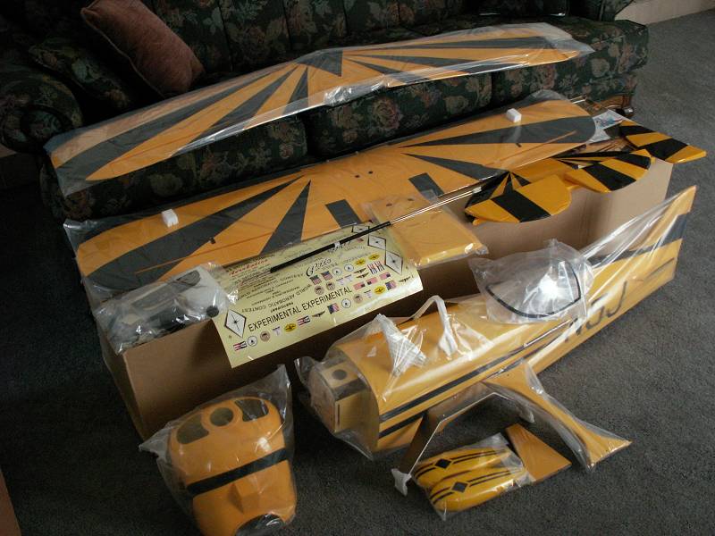

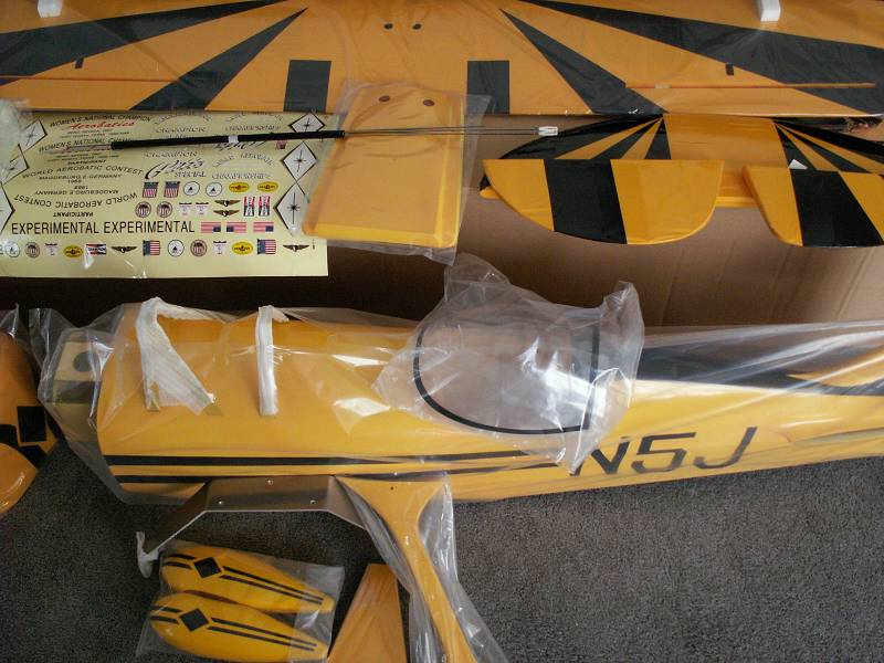

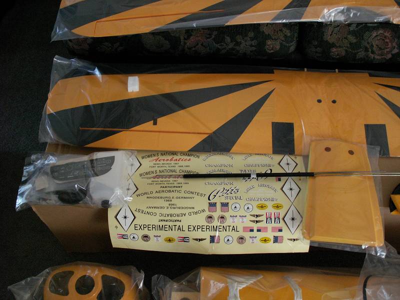

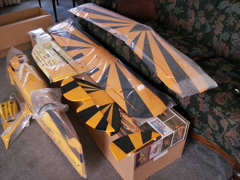

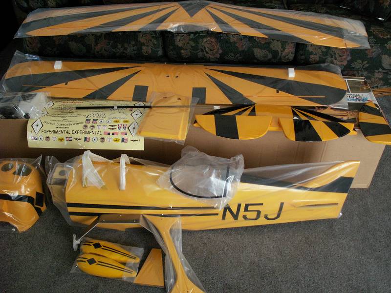

Had to buy it. I will mount a Super Tigre G2300 up front and replace the CA hinges with nylon hinges.

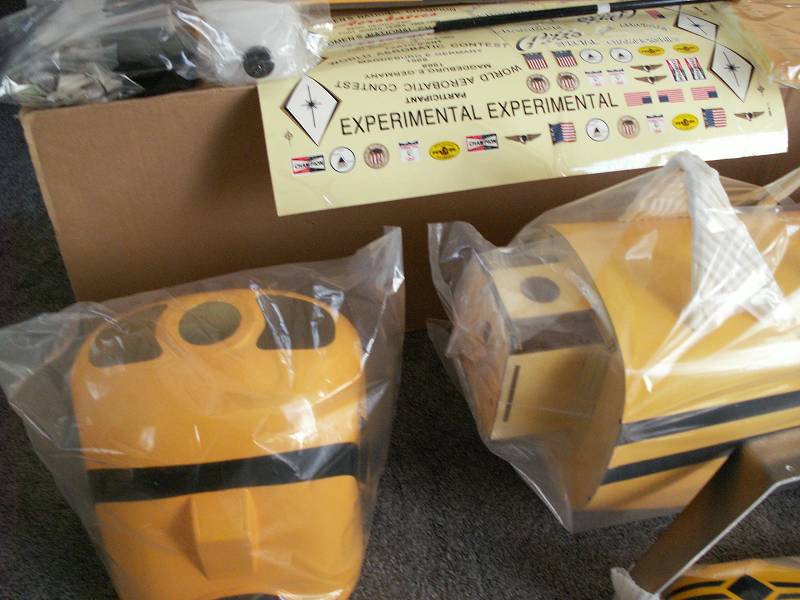

more pics

I saw one of these in my LHS and was really impressed with it. Would like to know how it turns out for you.

and more pics

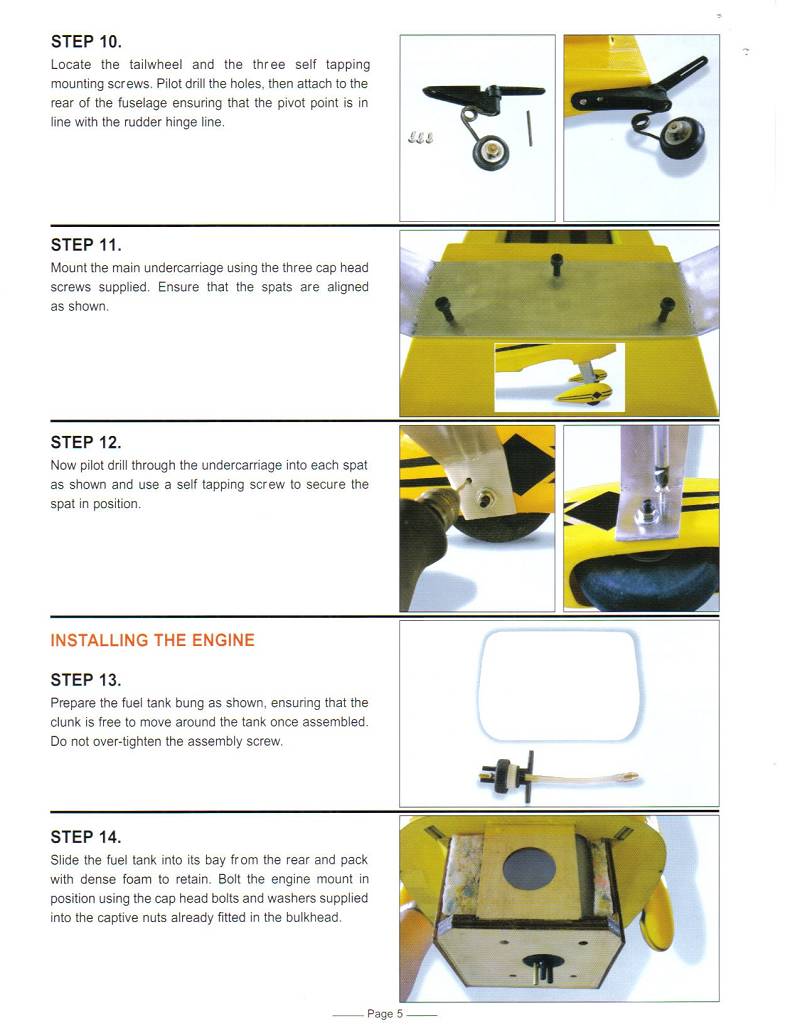

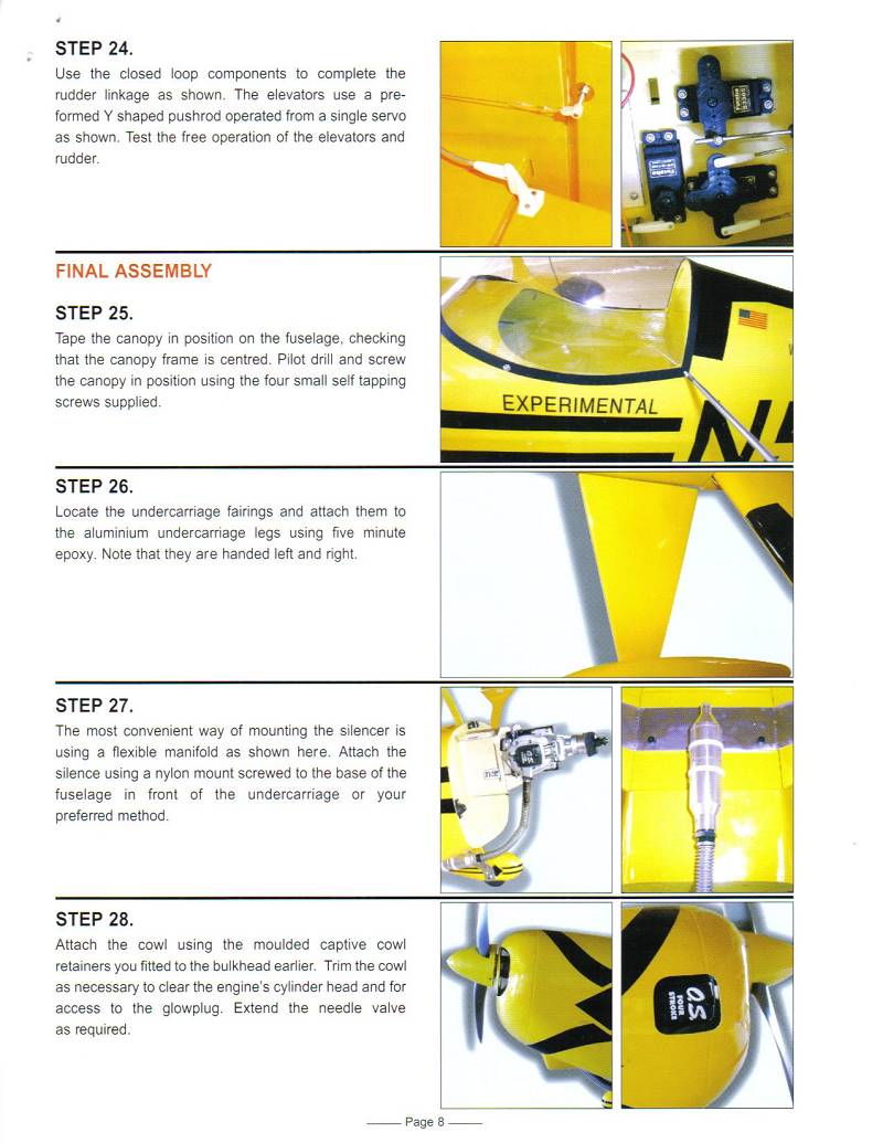

manual

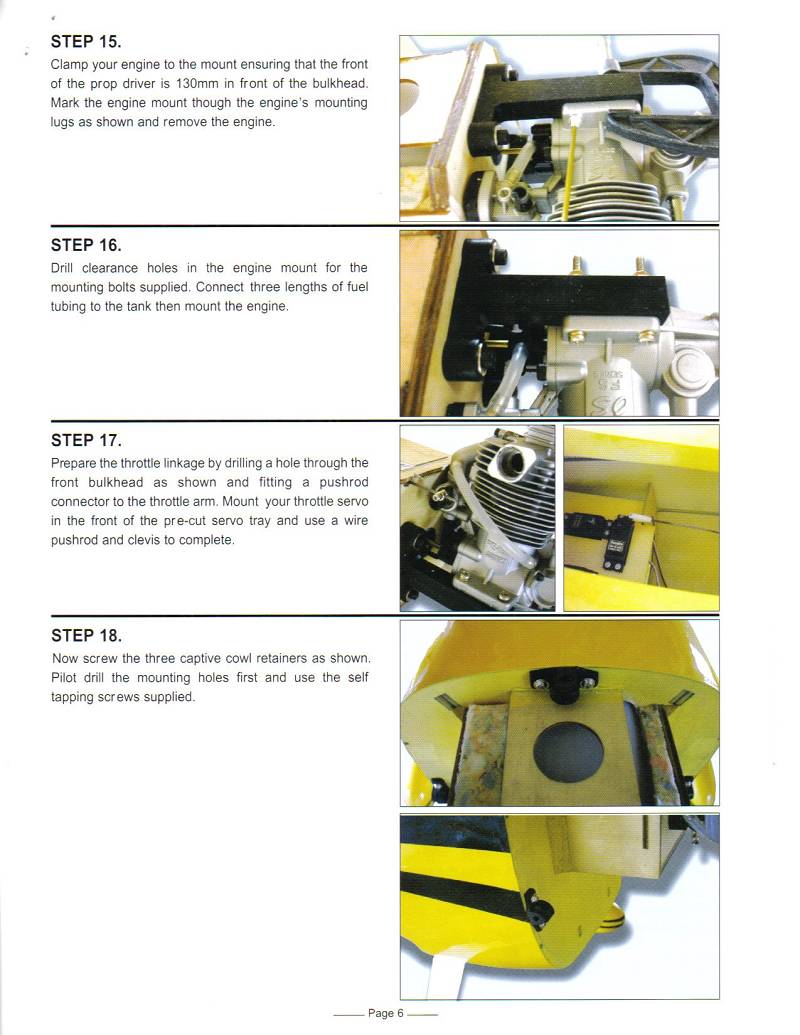

more manual

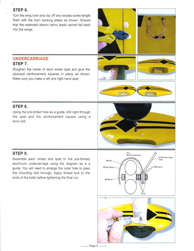

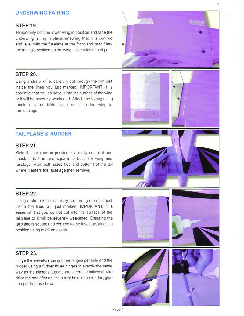

and more manual

When i looked at it the covering also looks like fabric, was just one more feature i liked. A good flight report just might have me getting one.

That is an awesome looking model. Thanks for posting the manual, that was nice!

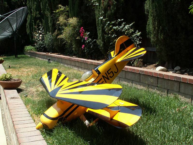

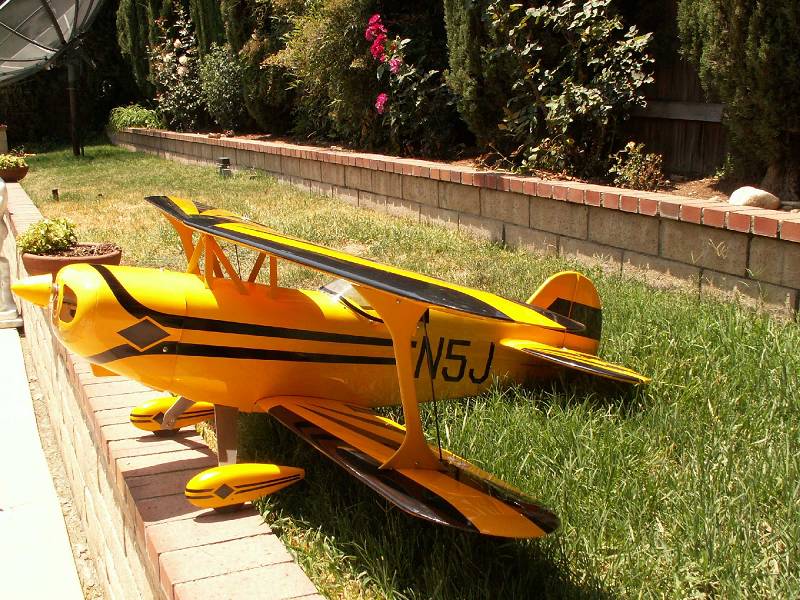

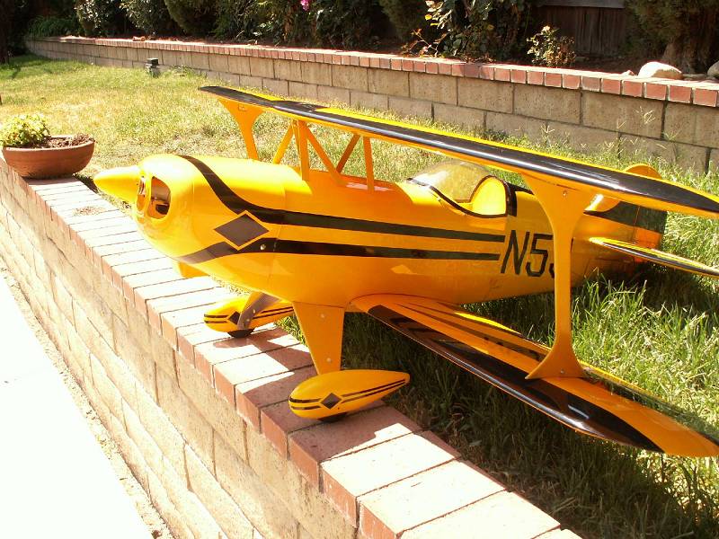

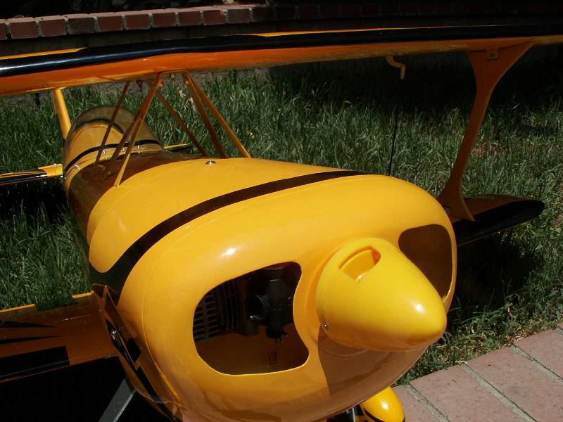

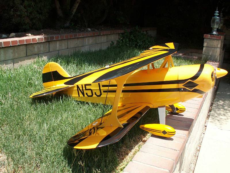

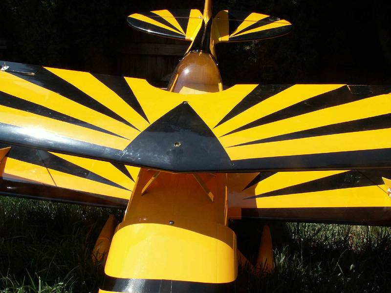

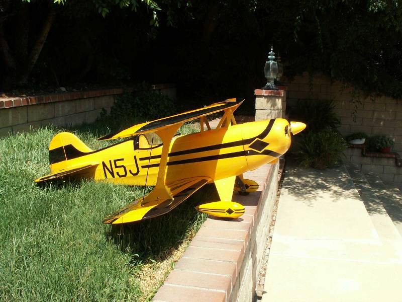

Well Boyz here she be:

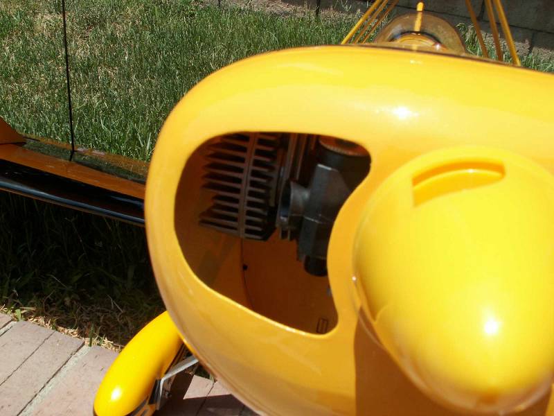

For those interested; the dry weight came to 9 1/2 pounds. The 1.40 Super Tigre will be more than blazing, and the balance with battery and RX ahead of servo tray is nearly dead-on. I did substitute a 20 oz fuel tank to accomodate the ST 2300 engine. There is plenty of room in cowl for the Mvvs 1.60 gasser if you desire. I will purchase another for this gasser when local shop brings them in. P.S. I also substituted a 4-40 pull system for the stock pull-system, as it did look a bit lite and I had the 4-40 in the shop.
Plane should fly superbly. I would avoid damage to fuse as repairs would call for fiber-glass, very lite glass at that.

I hadn't seen this plane before. It's the right size, but appears to light and perhaps weak for a 50cc engine and smoke sytem. I say that size because thats what I got.
What are your thoughts. Also is this plane strong enough to take any kind of wild 3D you want to throw at her. How is whe inverted, knifeedge, etc.
PS: this plane has a fiberglass fuselage? Ouch!

The ST 2300 is Ideal for the plane, and will do everything ya want it to do, and then some.
