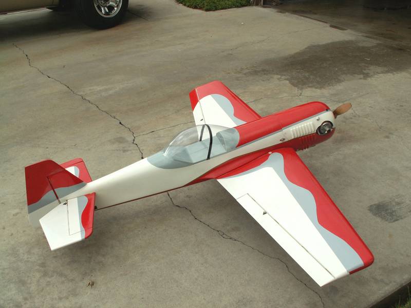

I have two, one with a G2300 Super Tigre and the other with a Mvvs gasser. The planes do fly nicely, howerver, you must reinforce the landing gear. I fiber-glassed a piece of ply for that purpose. Mount servos under canopy as the plane is tail heavy.

thanks for the tips
which MVVS> 26 or 35 ? is it a good match?

I have one, and fly very very well with a Y.S 1.40 FZ. If you are interest in this plane, move servos and batteries to front.

Mvvs or Evolution 35 would be better match if mounting servos in rear, but watch your prop clearance.
