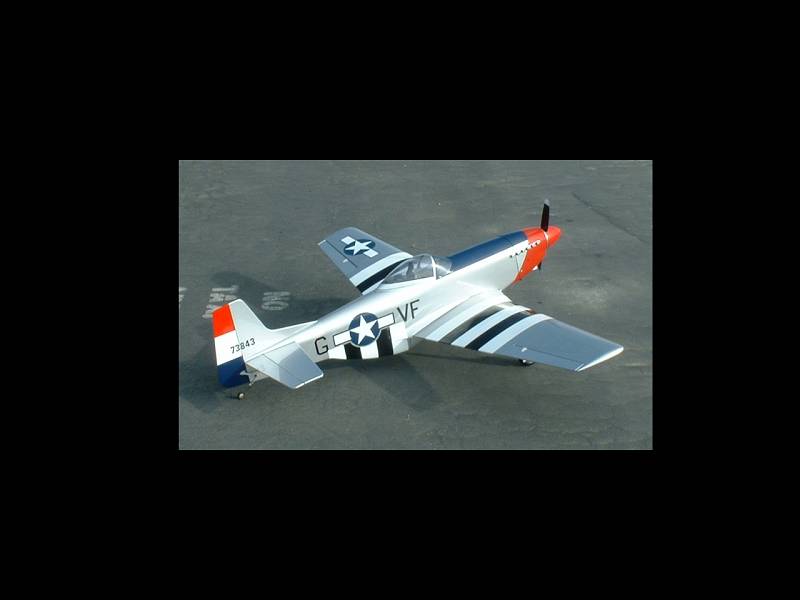

I got the Marie, but it wont be her for long. Itll be od green, aluminum, and red. Ive found some I like, but not "the" one yet. I like checkers so.......still lookin for a pic of the right one.
The hellcat gear works fine on grass, so Im hopin the stangs will be fine too. If not, I'll make them work.

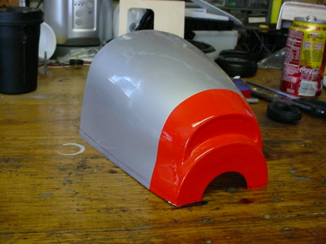

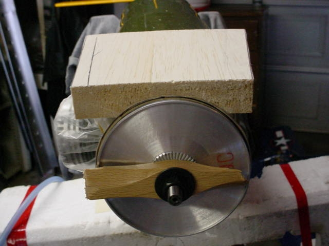

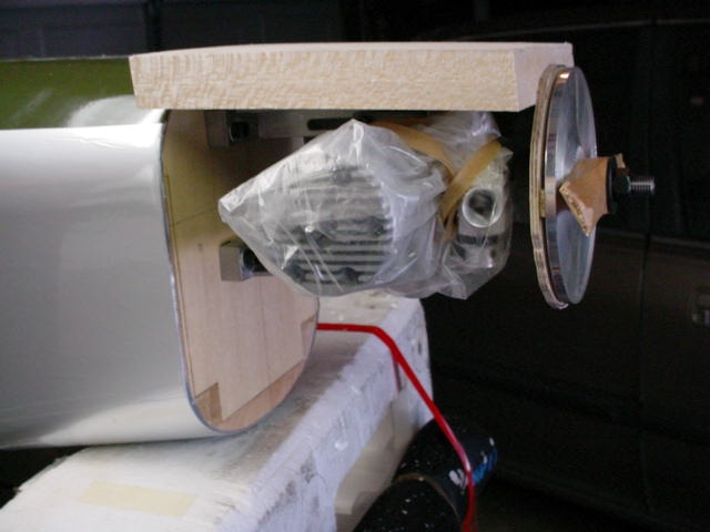

Just got the plane......it looks okay...so far.
The only things I dont like so far are, the way the cowl overhangs the fuse.
And the fuse sides, where the lower portion of the rearward radiator scoop join the sides has a nice glue bead that looks like poop.
Itl have to be uncovered and sanded.
After I find the miss a thead...... I'll decide what mods i want to do like, flaps........inner doors.....etc etc etc.
Right now, the only mod I wanna do is build the fuse out to a cowl ring and use the lower part of the provided cowl to cover the rest.
I also will be adding a robart retract tailwheel.......although it apears that it will have to retract rearwards instead of forwards.....I just want it ouit of sight on those "wingover dive ins" into the "highspeed hair re-arranger"........
I think Il also lower the cockpit floor to make a larger inst. panel with the gauges I got.
Oh well...thats it for the moment..heading out to join the wing halves.......
