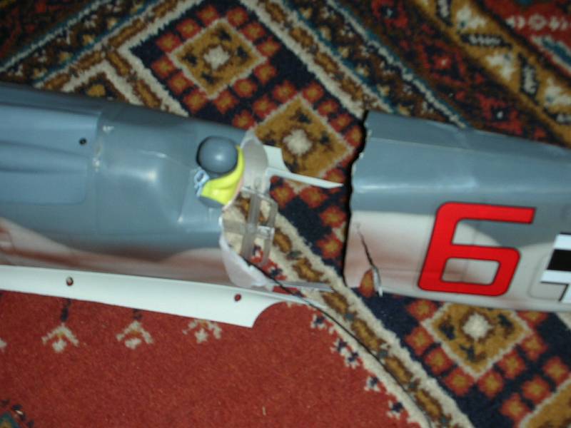

hey guys, i brought a parkzone fw190 yesterday, put it together and was flying it with much enjoyment (little bit twitchy due wind), on the second landing (not a bad landing) the fuse split exactly in two just behind where the pilot cutout is, no objects on the ground for it to hit, just seemed to split! has anyone heard of this before? has it happened before? what would be the chances of getting a replacement fuse out of parkzone? very small i guess......if anyone has any suggestions i would much appreciate them

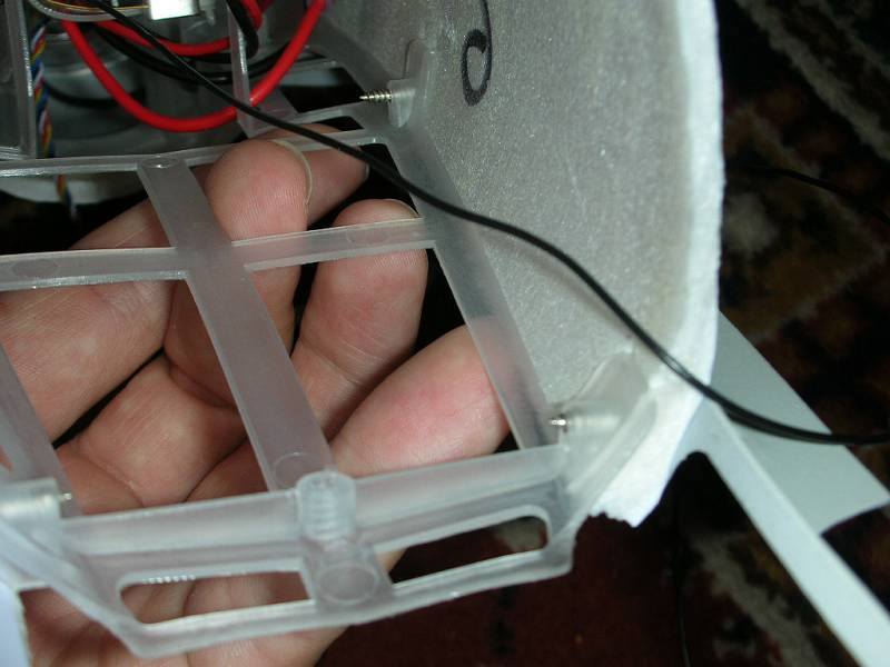

you can see on these pictures where it has broken, if you look on the close up on the left hand side a length of white double sided tape without the backing sheet removed has been installed between the plasitc servo/structre and the foam fuse preventing the lugs from pushing into the foam as with the other joints, it hasn't failed at this point but the opposite side, i wonder if it hadn't loaded up the foam or bent it, and the landing impact just broke it? i have no idea why the tape was there, i didnt' install it, anyone got another opinion?, i am quite annoyed, because the for the brief time i flew it it was much fun,

i did the epoxy repair with some balsa doublers on the inside, its fine, but very frustrating, especially when you dont know why the thing split in the first place!

Just checked mine; it has that white tape in there too. No idea what its purpose is?

Update: Well, mine broke in exactly the same place the first time I landed it yesterday. I admit it was a bit of a hard landing though. It looked exactly like yours Heavy1000; that could be a picture of my plane.
It seems pretty clear that there's a weak spot there in the fuselage. It looks to me like the cutout for the pilot figure on the top of the fuse, combined with the cutout for the wing on the bottom leaves only the foam sides of the fuse to support any stress on the rear of the airframe. Mine (and yours from what I can see) broke in basically a clean line from the one hole to the other. If I could make a suggestion to PZ, it would be to not make a hole in the fuselage to mount the pilot figure; just glue it to a solid-top fuselage. That extra hole seems to compromise the fuselage strength pretty badly.
Oh, and my fix? 20 minutes with some Gorilla Glue, packing tape, and 2 small wooden doublers glued across the break inside the fuse. It's solid, probably stronger than new (if a few grams heavier). Nice thing about foam planes; that would have been hours of repair and recovering if this were a balsa kit.
