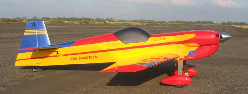

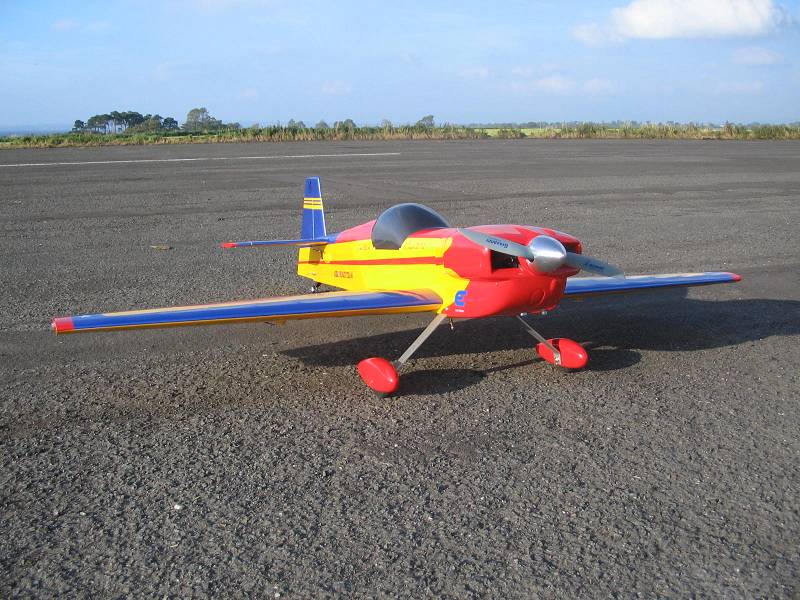

When I was in need of a quick build model last August I discovered that no-one had any of these in stock. As the review had given a big thumbs up to Black Horse I went for the 81" Cap232 they do instead.
For the record, very well packed and quality of finish is good. I found the instruction give extreme detail on how to assemble the fuel tank, I think most of us have that one sussed by now, but give no info in areas where you needed it. That said, if you are going to buy this model and be experienced enough to fly it, you will be able to fill in the blanks in the manual.
I fitted an Evolution 36cc petrol and so far have had one flight. I am currently adding air deflectors in the big cowl to ensure the engine is happy.
It flew well, just fits into a family hatchback, and looks good too.
I would be happy to give another Black Horse ARTF a go, still fancy the Ultimate. If anyone has an answer to the C of G it would be good to know.

I cut up some drink cans and used the thin foil to make the air deflector. Even so I may chicken out and cut another cooling hole in the cowl infront of the engine head. Really don't want to cook my Evolution engine.
I have added some pic's of the Cap, hopefully, never tried an upload here before.
