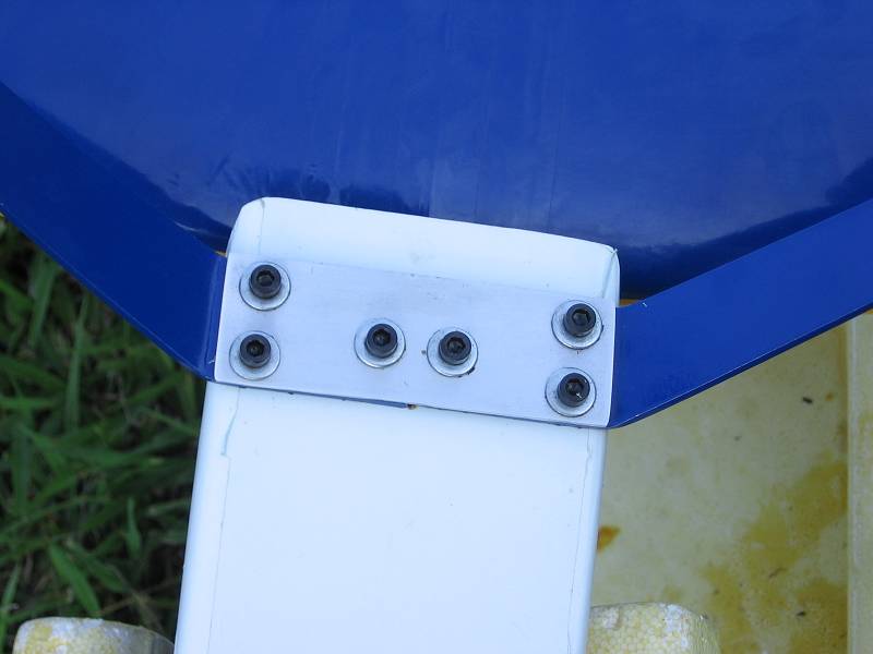

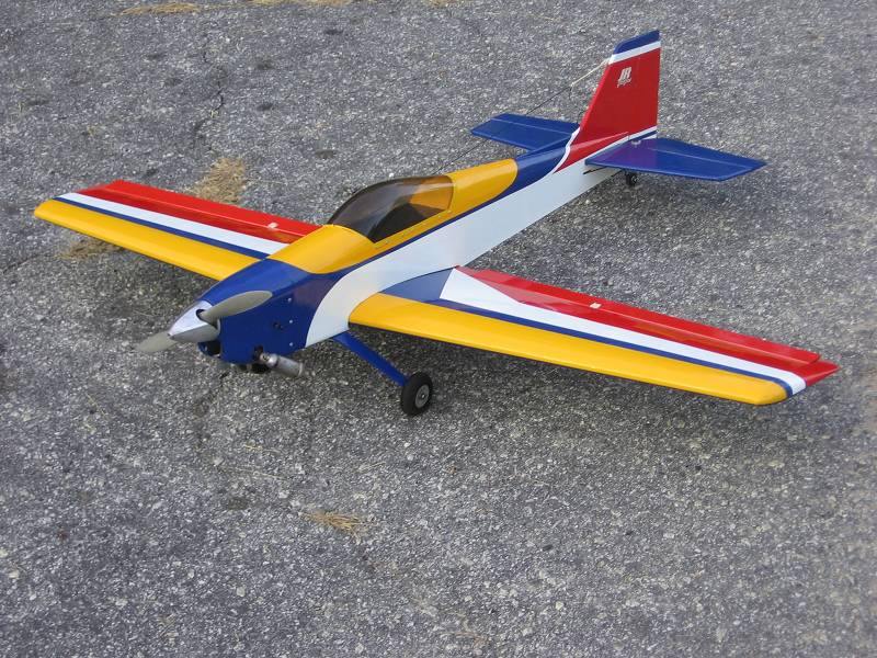

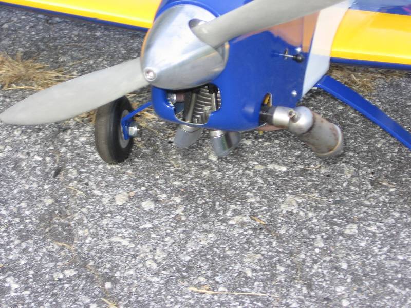

I've been flying a Saito 82 powered Aresti for several months now. It can be made in to a great flying plane, but be prepared to play with control throws, cg, thrust line, etc, to get it that way. Also IMO it needs a few mods, especially if you're using an engine on the high end of the recommended power range.
Also looking at this plane for a friend and wondering if his .32sx will be enough engine for it? He is looking for something to do simple areobatics with.
I think the 32 would be marginal on this plane unless you could keep it VERY light. Also, the Aresti is happiest when flown at a pretty good speed. I'm using an APC 12.5x9 prop which the Saito turns at just under 10K rpm on 30% heli fuel and find myself flying at or near full throttle for most of the flight ( except on down lines, of course ). It just seems to lock in better when flown this way.

Thanks for those nice pics edave. Are you using onboard glow on your inverted Saito?

Nope, no onboard glow driver. It took a couple of gallons for the Saito to fully break in and idle like it should, but since then, no problems. I would recommend a remote igniter though, just to make things easier on yourself.
