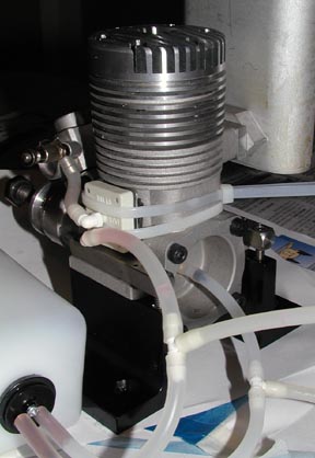

Its been over a year since I acquired the Hanger 9 1/4-scale Cap 232 and the Moki 180. This past week I finally started assembly.
Yesterday was my first session with the Moki 180 on my test stand. I had a hell of a time getting it started but am convinced it was because my glow starter didn't provide enough juice to the OS #8 plug. I eventually dug out my power panel starter and cranked the juice up to maximum GREEN. Ten minutes later she was purring at 6000+rpm with an 18x10 Zinger.
Per instructions from the Cline web site my setup configuration:
a) Large fuel line from the carburetor inlet to the output of the Cline regulator.
b) Large fuel line from the input of the Cline regulator to one side of a "T" connector.
c) Large fuel line with a stopper installed connected to center of the "T" connector.
d) Large fuel line from the other side of the "T" connector to the fuel tap on the 16 oz tank.
e) Medium fuel line from the crankcase vent tap to one side of a "T" connector.
f) Medium fuel with a stopper installed connected to center of the "T" connector.
g) Medium fuel line from the other side of the "T" connector to the pressure tap on the 16oz tank.
24 ounces of fuel later found me fighting the daylight so I dismounted the engine and put it up for the night. My experience did leave me with a couple of questions:
1) I had heard that the Cline Regulator system was based on demand and would not pressurize the tank. I'm here to tell you that when I disconnected the plug from the crankcase "T" connector it there was quite a bit of residual pressure left in the tank.
2) The break in instructions called for initiating a starting needle adjustment between 4 & 5 turns out from stop. It also suggested the the engine should be broken in a full throttle but rich enough to prevent rpms in excess of 6000. After I started the engine with the initial setting I tached it greater than 7000 rpm. I further richen the needle SEVERAL more turns and still ended up with more than 6000 rpm -- I didn't go any further because I almost totally unscrewed the needle and it still didn't go any slower. I did reduce throttle down to 6000rpm.
I'm only 24ozs into my bench breakin. I'm going to continue this until I've gone through the entire gallon. I will continue with the sloppy rich setting for an additional gallon with the airplane in the air. One of the last things I did before shutting down was to do a preliminary check on the engines ability to idle. I closed down the throttle to the stop (I could still see a very tiny opening inside the carburetor throat.) and the engine continued to run at a ridiculous low idle -- had to throw a rag into the prop and even that didn't work on the 1st attempt.
I'm beginning to think this engine is going to dramatically over-power this 1/4-scale Cap and I'm going to love it. I'm especially looking forward to a head-to-head comparison with another club member's plane with a Saito 180 on it. There is no doubt in my mind that the difference will be very noticeable.

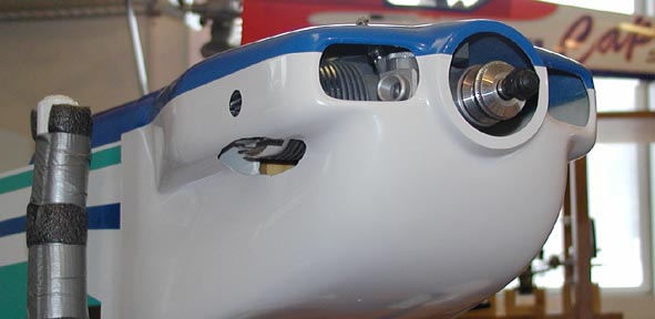

Chris,
Thanks for the suggestions.
I have liberally coated the entire nose section with epoxy and will continue to monitor the firewall for delamination -- it sure looks strong to me in its current configuration.
I already reinforced the dowels themselves -- inserted the wood dowel into carbon fiber rods and installed them into the wing. I did this because I wore groove lines in the dowels on my US 60. I have also thoroughly coated the wing dowel plates themselves with a liberal coat of epoxi -- again I will keep a close eye on them and endeavor to try to strengthen them even more.
How did you mount the Moki 2.10 and how much of the cow did you have to carve? I asked this because I am using the provided engine mount and find that, although the prop shaft lines up in the center virtically it is a little bit low horizontally. I will have to mount the cowl with a very slight down angle to center the shaft. I also had to carve the cowl on the left side to make clearance for the bottom of the cylinder when the engine is mounted sideways -- I will probably carve an opposite slot on the top of the cylinder as well for good airflow
Your thoughts???.

You cannot use the radial mount due to the design of the Cap's firewall. The engine installs just fine with the mounts supplied with the airplane. The only problem I see is the virtical alignment of the shaft with the cowl -- I will have to tilt the cowl down slightly to center the shaft. The horizontal alignment was perfect.
I experienced the same thing on a recent project. But I used medium fuel line throw out without a cline regulator on my Moki 1.80. I too could not get a reading of less then ~6500 at full throttle with high speed needle screwed out until it almost fell out. I replaced all the medium tubing with large tubing including the clung and brass tubing in the tank. Now I can get a very rich run at full throttle. So you may need to do that.
-Scott
Fuel line is all large except internal to tank. I was actually told that the only critical line is between the regulator and the carburetor.
My break-in is currently on hold because when I tried to run it today is started backwards, threw the prop, and almost ran away -- don't know what it got to without the load from the prop. Lucky for my I found both the prop washer and prop nut. Its just too cold and too difficult to start this engine because of that.
Here is my fuel line configuration:
