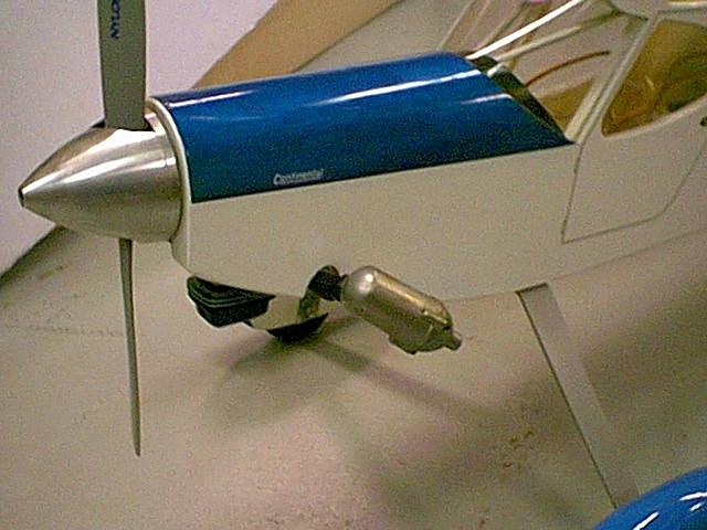

I would like to put a nice 4 stroke in my Sig Rascal 40. Tower suggests .53 as the largest. What are ya'll using and how much did you have cut away. Pics would be great if you have them. Thanks for the help. Oh ya will I be able to use stock muffler on a Saito 4 stroke. I have never had a stroke - are they a lot to maintain?

I put a YS 63 in mine. Only had to cut a small opening for the exhaust header as seen in pic. The YS 63 pulls this plane vertical like a rocket! Any four stroke around 50 size will work fine.
Jim

Put a satio 56 in it. You will be glad you did. It's a tight fit but it can be done. You can trim back the lip on the bottom of the engine comparment to make it more accessable.
