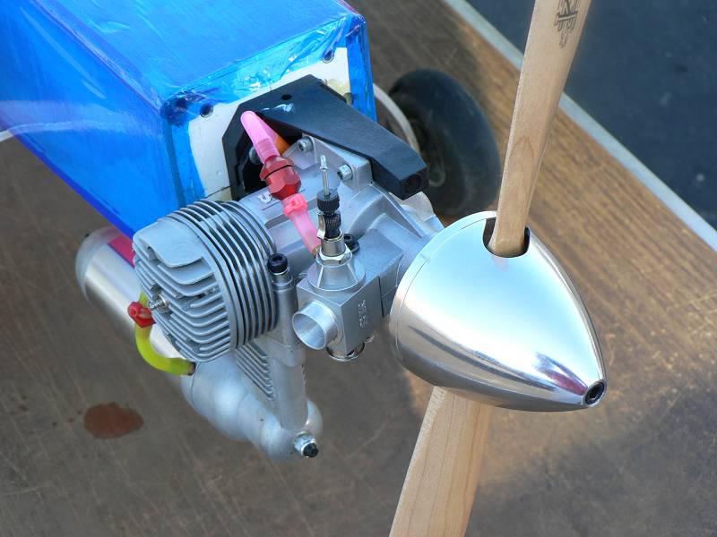

Here are some photos of it on my rebuilt, trashcan Ultra Stick. Another flier threw it away, or gave it to me rather than tossing it.
The 2 1/2" spinner is from the same dealer, kangkeusa.com. It was $15.77 and includes the 5/16 nut and bolt. The cutout fits a 15-6 perfectly.

You're not being fair to the local gurus, Ed.
Experience gained over many years of flying says that .90 two-strokes run best with a 13x8 to 14x6 prop. Then comes along SK with their different port timing, etc., and this upsets the apple cart. How would anyone know about this lower tuning by looking at their advertisement copy?
By the way, I just ordered one of these SK .90s so that I can experience the lower rpm power band of this engine. It sounds like a good idea, especially for those flying 3D these days. Also, I've been on a low rpm two-stroke kick for a while and have been collecting old OS.61SF engines, for just this reason.
So, I'm not bad mouthing Kangke, or saying that the 15x6 requirement is not true (I'm being educated too), but you have to admit that before this engine became available, the vast majority of .90 sized two-strokes did utilize props that would permit the engine to rev up a bit higher.
