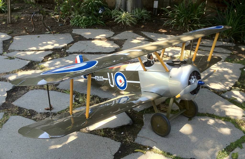

Old 04-15-2012 | 02:30 PM
  #1127
Joined: Nov 2010
Posts: 274
From: Los Angeles, CA
Default RE: Hangar-9 Sopwith Camel Build Thread
Thought I would share the fixed landing gear and new wheels. Ended up painting with house paint and sealing with Krystal Clear flat. The Williams are a tad heavier than the stock wheels and I may be able to remove a little lead.
Harry<br type="_moz" />

Old 04-16-2012 | 05:50 AM
  #1128
Joined: Oct 2011
Posts: 85
From: Fredericksburg, VA
Nice detail work om the wheels!

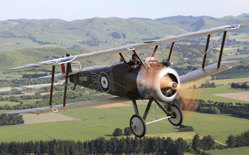

Old 05-13-2012 | 04:13 PM
  #1138
Joined: Nov 2005
Posts: 1,961
From: Auckland, NEW ZEALAND
Yep, but not so much to see as it was pretty closely guarded. I am in awe of those guys, sailing a bit of plastic and then getting some pretty horrendous injuries, and having to just put up with it until you get to some land...and bounced the whole way.
So far as the trim you see, yeah, they need a pretty good push to keep them level, not something to be done for any length of time. The pilots have a bit of bunjee cord they can wrap around the stick for longer flights, to relieve the arm muscles. You can see how 'tail high' the D-8 flys, the D-7 seems to fly with the upper longeron along the line of flight. I will see if I can find a similar piccie of the Camel, just to see what it shows...
Evan, WB #12.

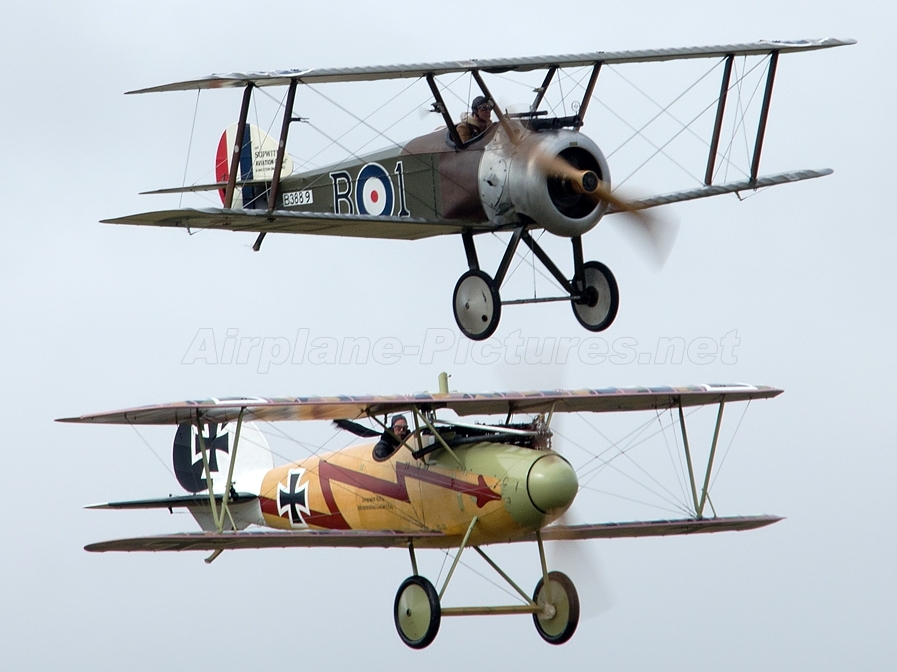

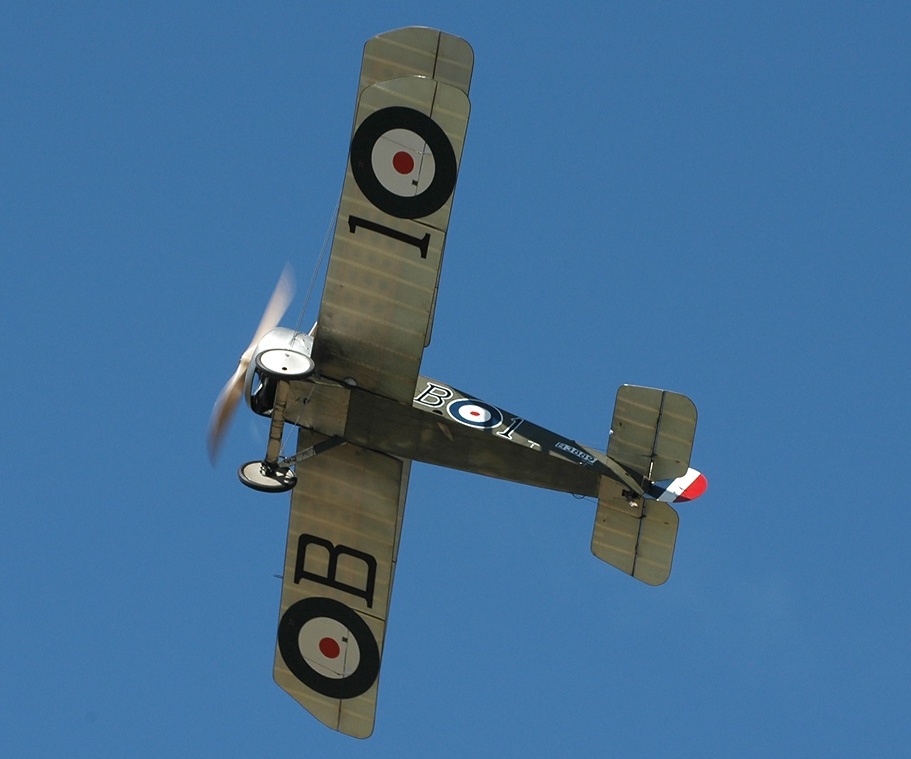

Old 05-14-2012 | 03:48 PM
  #1139
Joined: Nov 2005
Posts: 1,961
As promised...and some data for dirtying...
Evan, WB #12.

Old 05-14-2012 | 06:22 PM
  #1140
Mustang Fever's Avatar
Joined: Nov 2003
Posts: 3,225
From: Cadillac, MI
#3889 is really holding some down elevator. I hope my lifting tail eliminates some of that, anyway.

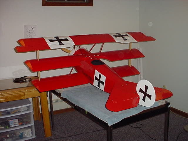

Turns out my design for the elevator didn't leave enough room for good iron hinging, so I'm going to have to try CAs. It's storming here tomorrow, so I should have time to work on it.
I goofed off today, put the first two flights this season on the DR-1. The more I fly it the more I like, it's so weird, like flying a stack of dishes around. The only thing I use ailerons for is to level the wings during takeoff and landing- that airplane is a rudder bird. It will roll, but I have to be patient.

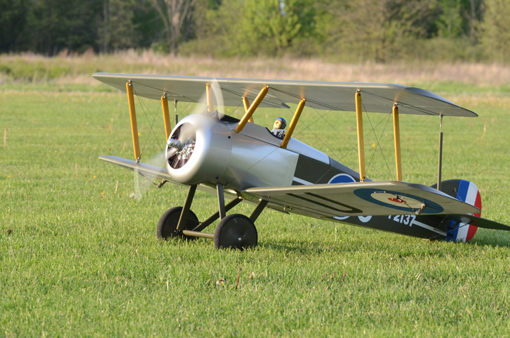

I'm still enjoying the Camel now with about 80 flights. At the field the other evening, there was no wind - and no other guys either! The aircraft flies so slow and stable that I was able to pick up my camera with my right hand and shoot some pictures, while guiding the plane with rudder and throttle. Yes it climbs slightly with throttle but I am OK with that. There is no trick about the ground shot.
ID:	1762816   Click image for larger version

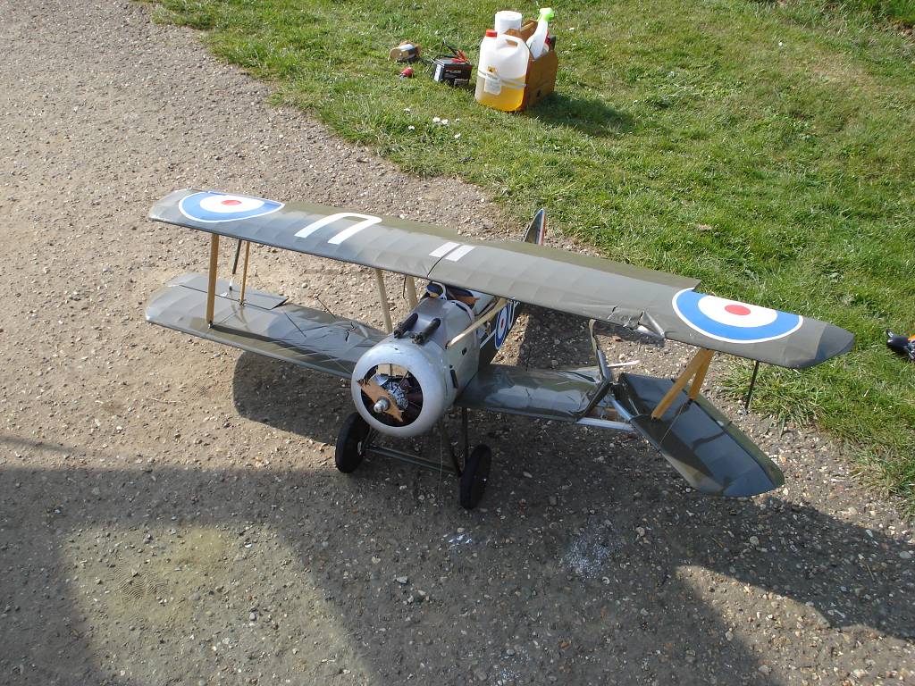

Old 05-15-2012 | 06:43 AM
  #1144
Joined: May 2003
Posts: 257
From: FramlinghamSuffolk, UNITED KINGDOM
I'm jealous - I twatted mine! (See below) Got to finish my Spitfire first though before I can start repairs on the Camel.

Old 05-15-2012 | 06:52 AM
  #1145
Joined: Nov 2010
Posts: 274
Bummer... they fly so nice unill you get on the ground. Easy to twatt.
Harry
Old 05-15-2012 | 06:54 AM
  #1146
Joined: May 2003
Posts: 257
I let it get too far away from me and it went out of range. It got off pretty lightly considering it was "free flight" for a while and went through some bushes and a tree!
